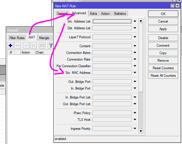

You mean port forwarding on NAT?
If yes, on nat rue, on advanced tad, there are src-mac-address field
OPS....
If yes, when you create new NAT rule, on Advanced tab, there is the src-mac-address field
