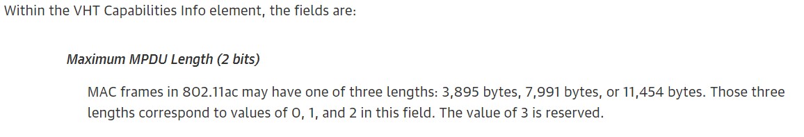

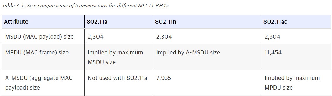

Reducing A-MSDU size is known for 802.11n to send smaller A-MSDU packages, and we hope it uses A-MPDU to package them further. A-MPDU has block ACK for each individual A-MSDU it aggregates and each A_MSDU has it’s own checksum. So if there is data corruption, only the corrupted A-MSDU need to be resent.
But with 802.11ac the max A-MSDU size depends on the MPDU size. And there a 3 values for those. Is the AMSDU setting in RouterOS still used for 802.11ac???
https://www.oreilly.com/library/view/80211ac-a-survival/9781449357702/ch03.html
Where Mikrotik default AMSDU 8192 uses 7935
What happens if you set 2048 for 802.11ac ? Are we tweaking irrelevant parameters? 8192 is the max value in Mikrotik wiki for AMSDU.

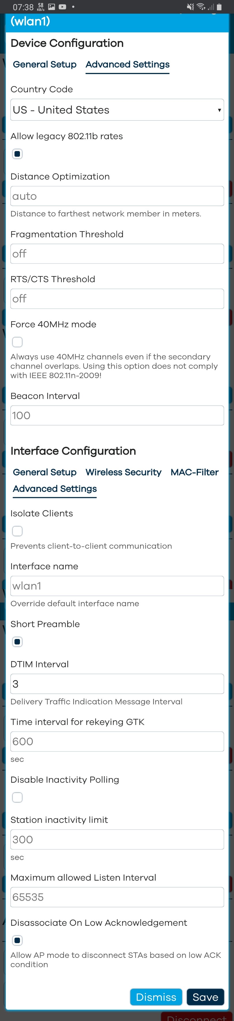

Just look at how many advanced WiFi settings the OpenWRT GUI on a hAP ac2 has and compare it to ROS, in OpenWRT almost everything is handled internally by the WiFi driver as other vendors do avoiding trouble and unnecessary tuning for the end user.
