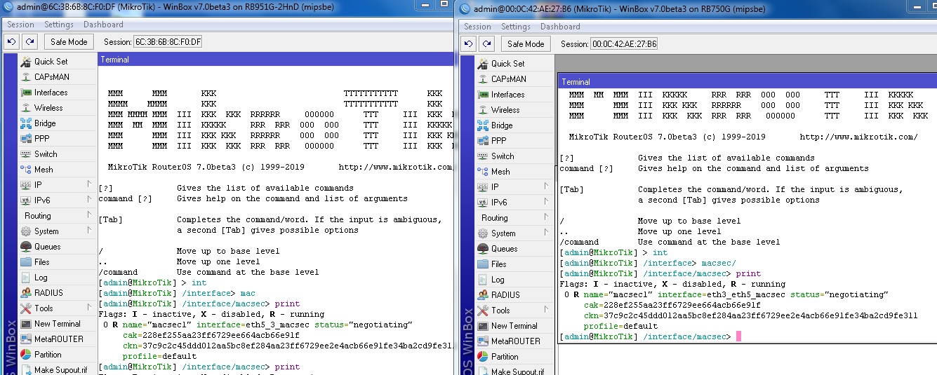

I am testing out MACSec(beta 3) on a RB951G-2HnD & RB750G, but cannot seem to get the two mikrotik units past “negotiating”.
I’m using the same cak and ckn values between the units, and the ethernets are of course connected together.
I’m using the same code(different interface names between the units !!
/interface macsec profile
set [ find default-name=default ] name=default server-priority=10
/interface macsec
add cak=228ef255aa23ff6729ee664acb66e91f ckn=\
    37c9c2c45ddd012aa5bc8ef284aa23ff6729ee2e4acb66e91fe34ba2cd9fe311 disabled=\
    no interface=eth5_3_macsec name=macsec1 profile=default
Any idea’s on this ?
