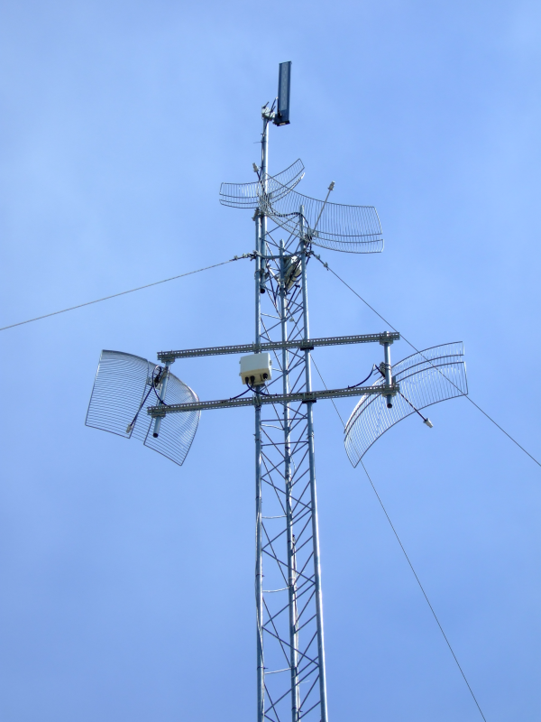

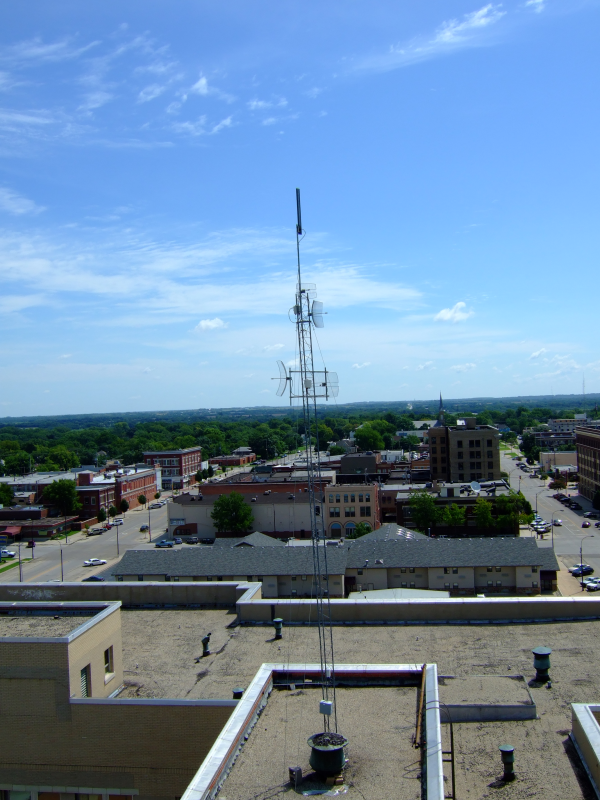

I have discovered an issue at a site where I’ve got about 100 customers coming in. It was configured with one Pacific Wireless 13dBi omni on one tower, and three Teletronics 22dBi sectors on another tower of about 1-2 meters lower height, about 20 meters to the west of the tower with the Omni.
Tower 1 - 40 ft Rohn 25G, 5GHz point to Point antennas, 13dBi 2.4GHz h-pol omni. Operating in 20MHz channel, 802.11-B-Only mode.

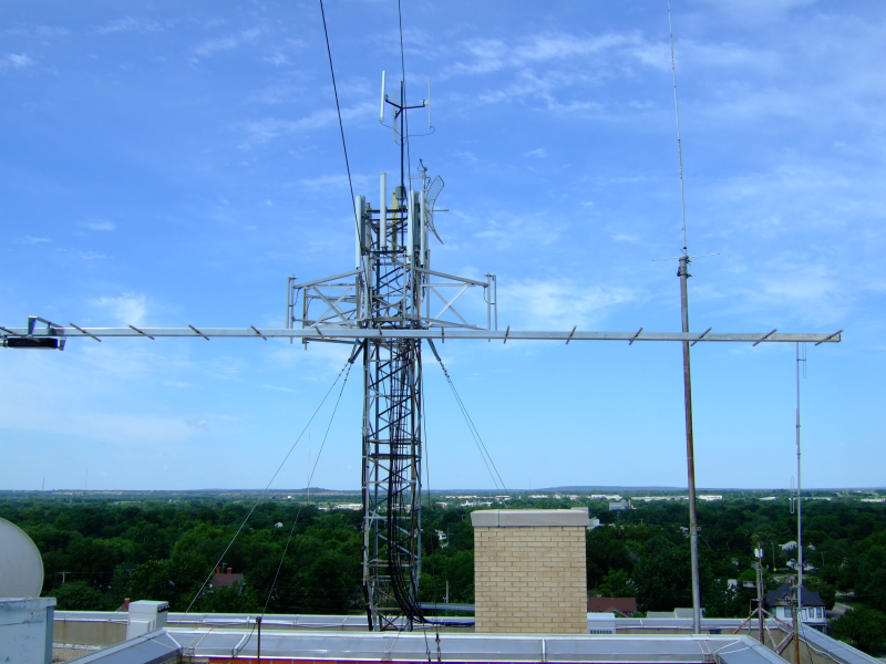

Tower 2 - 50ft tower. Unknown make. Has significant AT&T Cellular antennas. Our antennas are the very topmost on the tower, and are 22dBi teletronics 140 degree h-pol sector antennas. They are about 8-10ft above the AT&T antenans at the next level down. Operating in 10MHz channel, 802.11G-Only mode, NStreme enabled. Since the photo was taken, this was changed out to an 13dBi h-pol omni. No observable changes were made to performance, but signal strengths are stronger! You would think they would be lower going from 22dBi to 13dBi, but they in fact went up!

One of the AT&T cell phone antennas right at the base of my mast on tower 2 is lose and flopping. Perhaps the antenna is damaged? Could this cause 2.4GHz interference if it’s one of their 1.9GHz radios on that antenna? I contacted AT&T and reported the damaged antenna, but they didn’t give me a ticket number, weren’t willing to take my number for a callback, and basically gave no indication that they would do anything about it at all.
