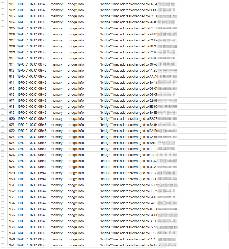

I recently updated to version 7.17 from 7.16.2 and encountered a major issue with bridges. Their MAC addresses keep changing continuously.
I’ve stripped down the configuration as much as possible, and the problem persists even with just the following minimal setup (tested on CCR, HEX, HAP, etc.):

Here’s a screenshot showing the issue:
After rolling back to version 7.16.2, the problem disappears entirely.

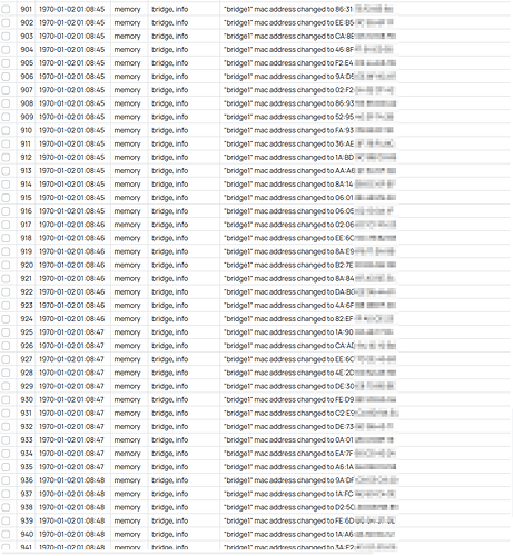

Out of curiosity: can you identify those MAC addresses? Could they belong to actual devices, talking to bridge? You obscured obe octet too many (3 most significant octets identify MAC address block owner) for us to check.
Even with just two, 8631, EEB5, CA8E, 468F are nowhere to be found in this list:

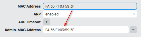

To confirm, you’re suggesting that the proper solution would be to manually set a MAC address in the admin-mac field for each bridge via Winbox, correct?
Here’s a screenshot of my current configuration to help clarify:
Let me know if this approach is indeed the right one.
Thank you again for your help!

Right, these are all locally administered MAC addresses. So it’s anybody’s guess where they are coming from, could be ROS as well.
Yes, it is the right approach.

From what you report - it seems like the RouterOS is “inventing” random MACs (as opposed to randomly “inheriting” those of connected devices).
It is a different kind of random.
But - as mkx noticed - they could be locally generated from “base” real MACs.
