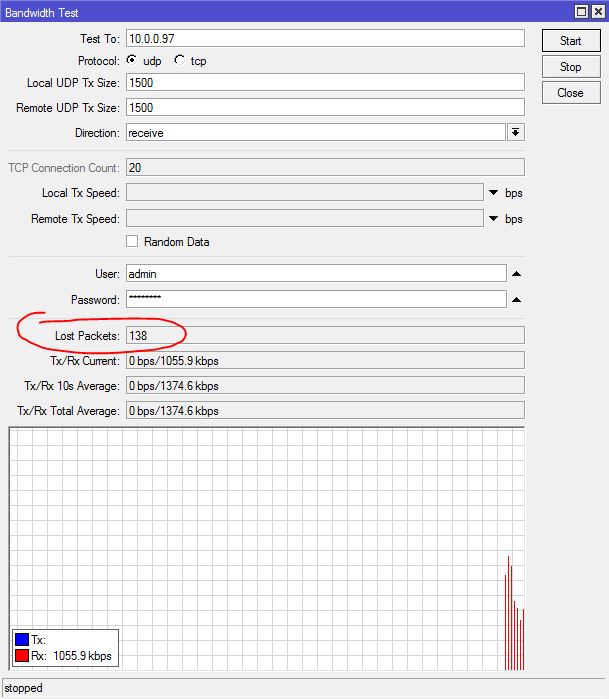

From the client: Tools, Ping: 10.0.0.1
Ping stats come pack perfect!! 40ms no loss, great!!
Again on the Client do this:
Tools, Bandwidth Test
Test To 10.0.0.1, with default settings:
UDP
UDP Size: 1500
Remote UDP Size: 1500
Direction: Send <--------------- First see send (This where this client transmits to the server)
Results are great: NO LOSS!!
Now change it to Receive, and test again, without changing any settings.
TERRIBLE RESULTS!!
I get loss of up 200 packets
Please someone explain this to me, and help me to fix this - ill be transmitting SIP / voice over these VPN connections and currently the voice quality is terrible… understandably since the loss is crazy.
This is normal behaviour with BTest - that is how BTest works.
With TCP you have a windowing mechanism that adjusts with internal TCP mechanisms and packets dont get lost.
With UDP, to detect max speed, you send packets untill some of them get lost - thats how you know that the link is maxed, and you simulate a “window” behaviour.
So dropped UDP packets on UDP speedtest with RouterOS BTest are completly normal behaviour - you are maxing your link.
Any link when maxed will drop packets.
Also, since you are sending at 916 pps (1.3Mbit/s at 1500 byte packets), and your BTest is running atleast 10 seconds (because the 10s average is calculated), that is actually just a ~1.5% packet drop.
You can see how good the “UDP windowing” mechanism in BTest is.
