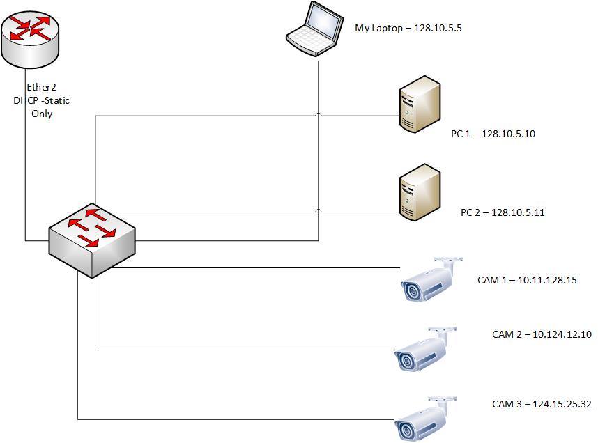

So this is my scenario. I have a RB2011 in the office, All the devices are connected to a static-only server (128.10.5.0/24) so I need to input each mac to assign an IP address for any new device. The thing is that I usually setup, and test devices (Surveillance cameras) that come to my office with other ip addresses configured; so what do I need to know to reach these devices (cameras) with other static ip addresses so they are reachable to my lan (128.10.5.0/24)?

Any VLAN’s?
Also what is what in this drawing? Is the rounded object (router) actually the RB2011? If so, what is the squared object (smart switch?)? Please identify what those two objects in the drawing are because if you have a smart switch that might be doing something with the routing of the networks that would be nice to know.
The picture doesn’t make sense until you label the devices with the red arrows.

Read the OP description again! He has a static network and is attaching devices that have static ip’s that are outside the scope of his network. He does not have multiple networks. I am truly amazed at how many give advise that truly does not read the full description, but only looks at the pretty pictures. :wink:
If the router is setup to use the 192.168.88.0/24 subnet and the device has a different subnet and he plugs it into his router. He now has two subnets on his router except that the router only knows of ONE of those subnets and what to do with traffic from/to that subnet. So the answer is setting up the device so it can talk to the router (i.e. reachable from the router, can ping the router) and then making the LAN subnet talk to it. So again, if you want to plug devices with different subnets and IP ranges into the router and have that router actual route that traffic, you need to set those subnets up.
So we do know what the OP is going for and that is why we are tying to figure out, are these other subnets programmed on the router? If not, then they need to be. If they are then they are not configured properly and routes are probably missing.
