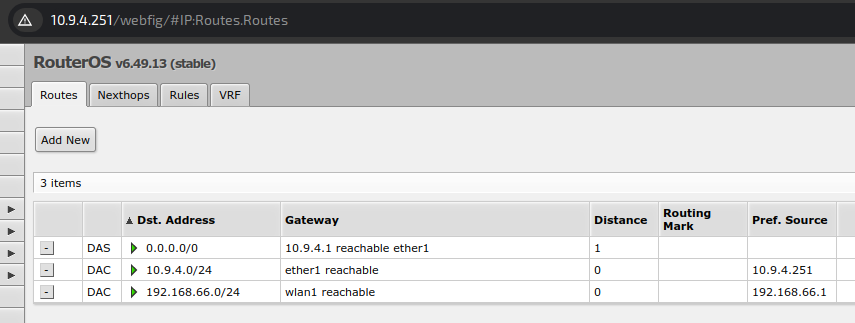

This setup is definitely unusual, but maybe someone can help. I have a mAP Lite configured with a separate Wi-Fi network for all the “not-so-smart” devices that need internet access. These devices are tunneled outside my public IP via AWS and don’t have access to my “real” LAN. Now, what I need is to be able to access those devices from the “real” LAN to their “fake” LAN.
real LAN: 10.9.4.0/24
pfSense LAN: 10.9.4.1
mAP WAN IP: 10.9.4.251
mAP LAN: 192.168.66.0/24
map LAN IP: 192.168.66.1 (of course)
I’ve added a static route in pfSense to 192.168.66.0/24 via 10.9.4.251, and it seems all packets are directed there correctly. However, I’m struggling with dstnat on the mAP. No matter what I try, I keep receiving ICMP unreachable errors.

You should add the reverse route 10.9.4.0/24 via 192.168.66.1 on map. Then you don’t need dstnat at all
Isn’t 192.168.66.1 already a default route for all map clients? Also wouldn’t it conflict with default WAN route 10.9.4.0/24 from the ether1 interface?
My bad, meant wrong thing. The device should be accessible from another network, if it has gateway configured properly (i.e. 192.168.66.1 for all IoT stuff behind mAP). Another suggest is why you can’t just bridge ether1 and wlan1 to have all management on pfsense?
Using bridge mode would place all my IoT devices on my LAN, which is exactly what I’m trying to avoid. I want a separate network for all those garbage devices while still being able to access them. Sure, I could place a WiFi client in that network and access it that way, but that feels like a workaround. I feel like I should be able to achieve this with the mAP.
Use VLANs to separate devices on a single bridge. Pretty sure you can manage all VLAN stuff on pfSense, which would be a nice centralized solution
