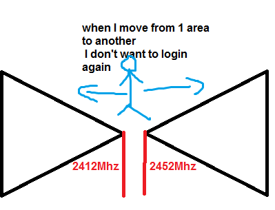

I’m using Router RB133 V5.24 with 2 wireless cards
the are both in a bridge and the hostspot is configure to the bridge (all is working good)
my hotspot is free from use (no pass needed)
both of them have the same ssid:“test” but 1 is on 2412MHZ and the other is on 2452MHZ .
this is all the config I have.
now I want to make that if I connect to the first WiFi(2412) and them go the where only 2 is available I wont be asked to do the login page again and I will still be at the hotspot , or (if it easier to do) if I connect to 1 and lost connection and return to it and\or go to 2 all this is up to 5 minutes - I won’t be asked to see the login page .
is it possible and understood what I wont?
Thanks ,

let me explain again:
I have 1 RB with 2 RF-cards
both of them are in bridge 10.0.0.1/24
all the hotspot configuration is from the bridge
I want that if I move from 1 rf card to another I won’t be ask to login again .
maybe this will help -
