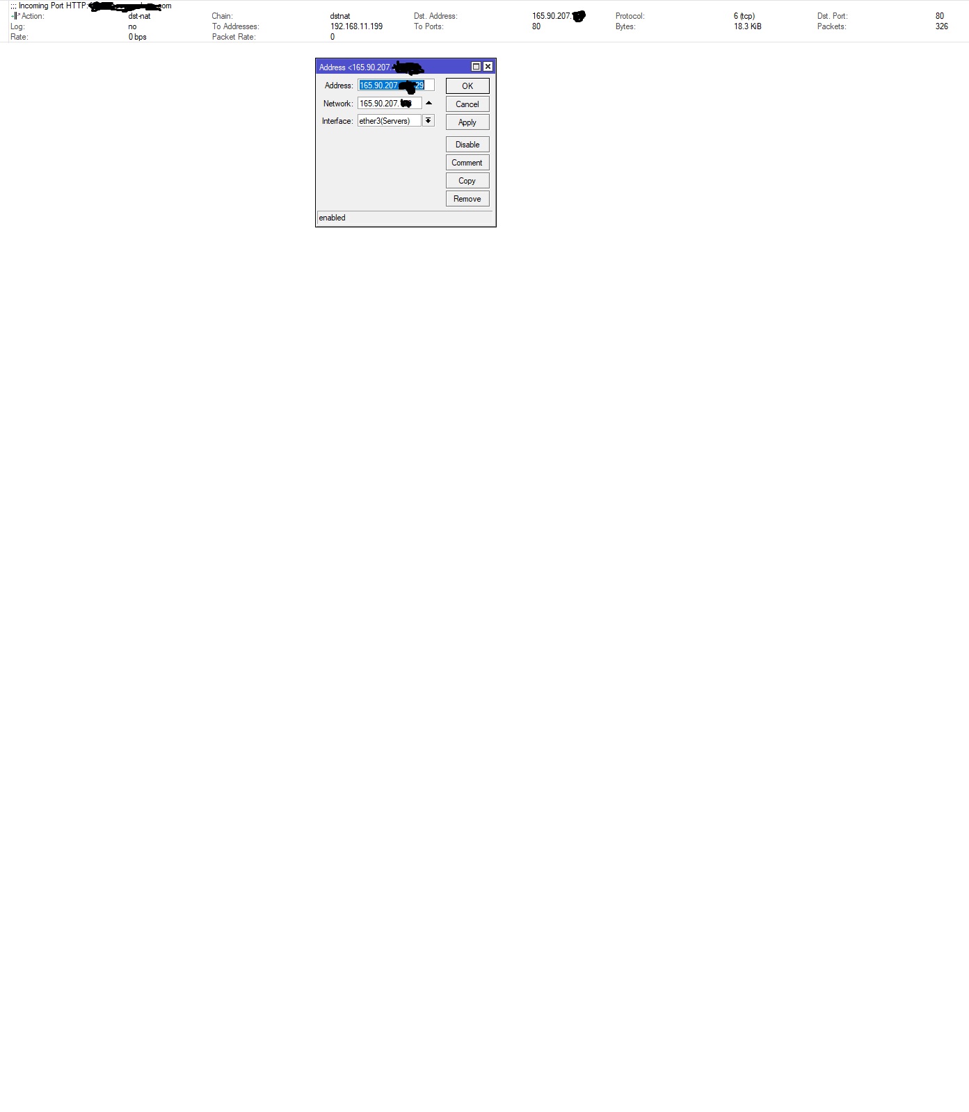

The mikrotik router is being used at my work and there are servers connected plus the internal network and so on. I have logged into the router through winbox. Then i made a NAT rule in the firewall. I actually just copied one of the existing NAT rules however i changed the internal IP and the static IP to match the internal IP i put on the server and the static IP which is pointed to the domain provider. Also port 80 is allowed. Then i added a new entry to the Address List. After everything was done i rebooted the router but i can’t connect to the server via ssh (using the internal or static IP).

I have attached a screenshot of what i have done.
Don’t really know what you mean here in question 2 [(2) Does counters of your NAT rule ticking?]
If you want connect to ssh server in LAN you need to add nat dst rule for 22 port. If you want to connect to router, you need accepting rule for 22 port in input chain. But be careful, I recommend you to use source address list.

Post here routes on router, nat and firewall rules.
