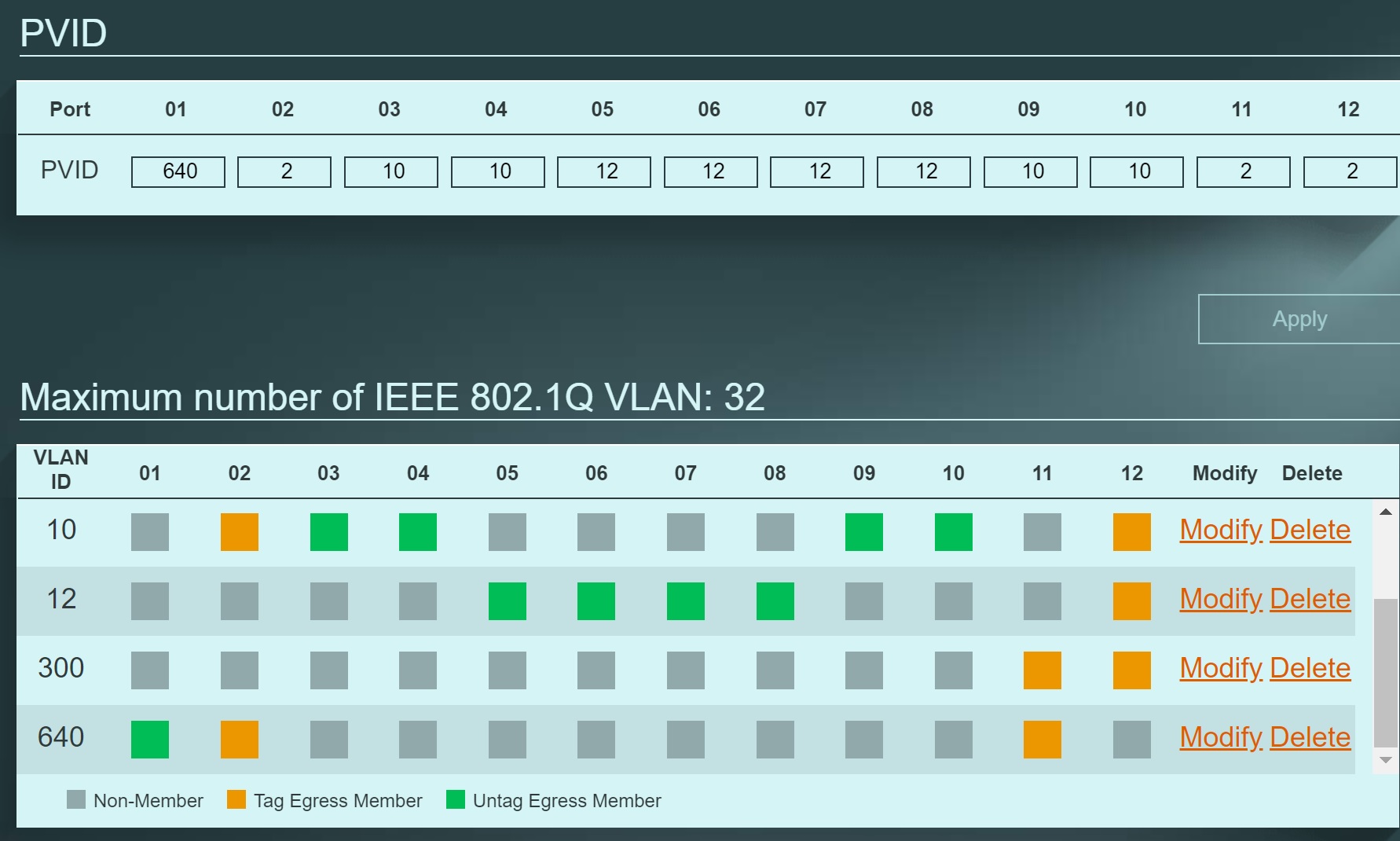

Make VLAN mgmt more easy, please
Why is it so difficult to manage VLAN’s with routeros ?
Taken an example from Zyxel attached, way easier.
This looks more like a switch config - routers are very different.

This isn’t that much harder with RouterOS. Here is the equivalent:
add bridge=bridge interface=ether1 pvid=640
add bridge=bridge interface=ether2 pvid=2
add bridge=bridge interface=ether3 pvid=10
add bridge=bridge interface=ether4 pvid=10
add bridge=bridge interface=ether5 pvid=12
add bridge=bridge interface=ether6 pvid=12
add bridge=bridge interface=ether7 pvid=12
add bridge=bridge interface=ether8 pvid=12
add bridge=bridge interface=ether9 pvid=10
add bridge=bridge interface=ether10 pvid=10
add bridge=bridge interface=ether11 pvid=2
add bridge=bridge interface=ether12 pvid=2
/interface bridge vlan
add bridge=bridge tagged=ether2,ether12 vlan-ids=10
add bridge=bridge tagged=ether12 vlan-ids=12
add bridge=bridge tagged=ether11,ether12 vlan-ids=300
add bridge=bridge tagged=ether2 vlan-ids=640
Note that on whichever VLAN the switch itself is supposed to get an IP on (management vlan) you’ll have to add “bridge” itself as another tagged port in order to still be able to reach the switch management interface after enabling bridge VLAN filtering.
