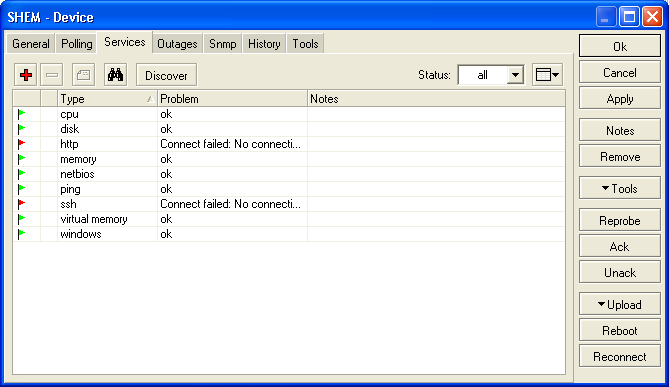

You said they are green so you evidently have ping added ping as a probed service…add more services that you know the machine doesn’t have. Add hpjetdirect, gopher, ftp, etc if the machine is just a router and it will turn orange; you may need to add 2 or more bogus services. 1 downed service should do…I’m not sure. Orange is for partially down…that should work…you really don’t want to see orange Kay, :laughing: If you need help with auto discovery let me know…adding a large number of devices manually just isn’t the way to do it. :unamused:

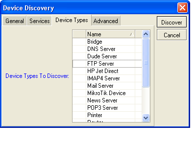

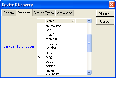

Can you ping your devices from within Dude without it bringing them down…YES. If so then you can use the auto discover function but de-select all the other service probes and device types except ping; if you’re really paranoid. I don’t want you to flood your network, but a ping is harmless. There is something else that is causing havoc, but it surely isn’t ping.

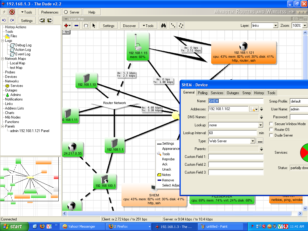

If you are monitoring ONLY ping on a device it will never go Orange, only Green and Red. If it truly is unstable and you happen to open “Settings” you will see that it is Orange/Unstable, but the Map icon is still Green. We want the Map icon to match the color on “Settings” - General. Yes, devices on the Map go Orange if SOME of the services you are monitoring go down and others are still up, but this does not happen if you monitor only ONE service.

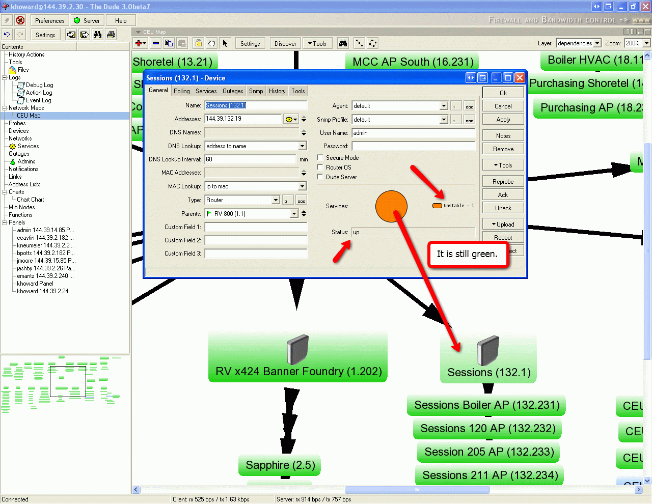

I think everyone is missing the point. I’m looking at a map. My map had about 200 dveices. I get a sound notification saying something went unstable. The map still shows everything green. I cant go through each one individually to see what is unstable. I have to look at my email which makes the whole point of the map irrelevant. I want to see a color change when it goes to unstable then another color change when it goes down. I don’t think this is possible currently but I am still working on it.

OK, you’re a liar :smiley: I have found NO WAY to make an object turn orange “ON THE MAP” when it is unstable AND (Very Important AND) you are only monitoring ping. If you are only monitoring ping, you get either Up/Green or Down/Red.

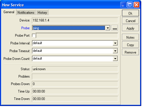

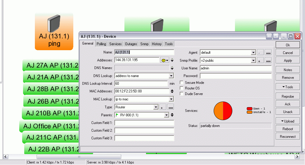

Seems like you want orange, but you dont define what constitutes ‘unstable’. I would think you are referring to packet loss, or flapping. Therefore, look at the ping probe parameters and adjust them down to be almost impossible to be considered up. There are retry and time parameters. If you said, if the latency is over 1ms, and only try once, that might make it change color. If possible, load the link to force the condition to test it. I am sure if it goes red, that will draw your attention, and if it isnt really down, and just sustaining packet loss, you needed to look at it anyway. If its down, you needed to be there anyway. You will eventually obtain your optimum threshold for your ‘unstable orange’ condition. Seems you want a tri-state device condition. Up/packet-loss/down. If there are only two states, this will still work because it will require your attention in either an unstable or down condition.
You could also have an alternate ping probe with a different name, but is much more sensitive. I tried to force this on my network, but the ping times are too low. But I observed another helpful indicator in testing. If you are using links with bandwidth indicated, at a certain threshold, they change color to indicate at least ‘heavy traffic’. That is very handy on backhaul links. Heavy traffic conditions could cause ‘instability’. If its an RF condition causing instability, thats a whole new topic.

I’ve got a 46" LCD screen on my wall with this map. My goal was to visually see what is unstable. We have a few throughout the day and some are more important than others. With “my precious orange” I can look up to see if it needs attention right away. If its the link to a switch with 2 users then they may just get a bit slow. If its a link to a switch with 45 users on it then I should probably look in to it right away. I do have the sounds working so I at least know that something is unstable and can check my email, but that still takes to long.

It works great. I created a second ping probe and adjusted the timeout and down count. I now have my “precious orange”…

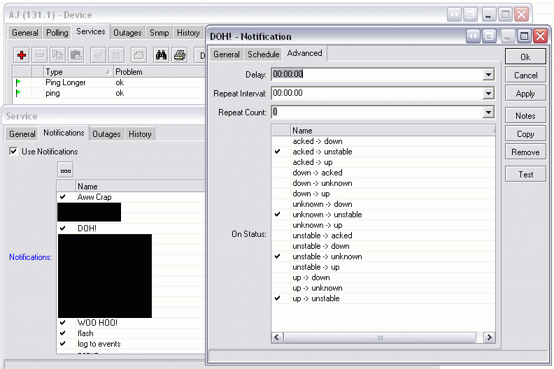

I have one problem though. When I had just one ping, I had a sound notification when the service went unstable and another when it went down. Now I have 2 probes and my sound notifications wont play until the service either goes down all the way or comes online. Its a huge delay and I want a bit more notice. Anyone have any ideas?
