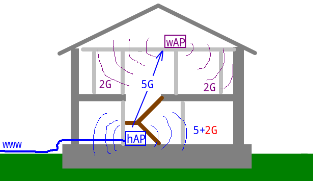

Currently i’m running HAP AC2, that’s a 2+5GHz access point with internet. A line-of-sight wAP AC connects to it’s 5GHz and bridges it over 2GHz, that provides connectivity on another floor. Any way i set it up - one SSID in repeater mode, multiple SSIDs with devices configured for all, multiple SSIDs with devices using only strongest it’s a mess - poor connectivity when walking around or dropped connections and suboptimal AP selection during hand-over etc. Would CAPSMAN solve this and what’s the best way to do it? Can i E.g. dedicate one frequency to management function and other to access point. Or better yet - keep both frequencies as APs with use of VirtualAPs?

  • Is there really no way to add somewhere additional ethernet cable ? Even when going through the wall outside and then coming back in (make sure to use weather/UV proof cable then) ? I once had a CAT6 cable laid through the wall of my home office, down the floor, across the ceiling of the garage, down to the basement and then back up to the living room where my main router was at that time.
    From the drawing you provided I would think something might be possible using corners of the walls and ceiling going up ?

5G is solid. The distance is small and there’s only wood stairs and ceiling in-between. Connection to 2G repeater on 2nd floor gives max speed. Stationary devices work well. Problem is mobiles - if they’re on one AP, they’ll suck on other floor. If i add them to both, they’ll drop connection on handover or stay on wrong floor AP with bad speed. Even with single SSID.
Wiring issue is the same as why one AP doesn’t cut it - concrete. Only options are use ugly plastic channels trough stairs or do quite some drilling and remodeling. Compounded by the fact the ISP dropped and crimped their fiber adapter in random corner i’m forced to use. Otherwise i could put my main AP right in middle of stairs. Anyway IMHO CAPSMAN is worth trying before i resort to tearing wallpapers and cutting cable channels in concrete.
So you’re saying 5G backbone should work? How would i set it up? Just have them connected as they already are ( 5G ap → 5G client ) and follow CAPSMAN wiki for 2GHz? Can main AP 5Ghz be used as both CAPSMAN and AP? Or CAPSMAN completely “occupies” the connection it uses for management.
Another thing i’m considering is moving the repeater further away. There’s an area where their coverage overlap strongly making it difficult for devices to select the best option. I’ve already reduced their TX power but that did little to help.
