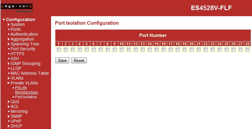

If remembered it correctly, I have seen PVLAN in the administration of Accton Edge-Core ES4528V http://www.edge-core.com/ProdDtl.asp?sno=306, it also have complete IPv6 management. I got one for 400€ with VAT (in CZ).
