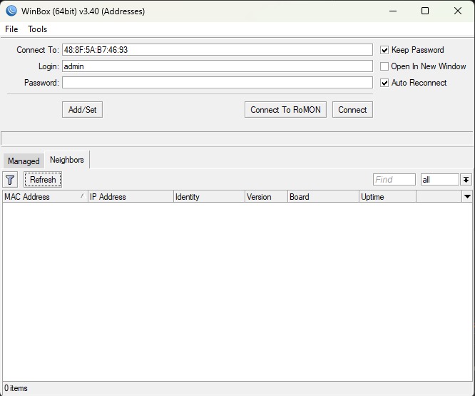

Right now I have the RB941-2nD (hAP lite) with hotspot configuration, but because the TV and CCTV won’t connect I reset it and accidentally removed the bridge interface, and now it won’t even show up on Winbox neighbors
