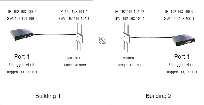

Hello, I am completely new to mikrotik. This is my first device.
Can someone help me with the settings.
I am sending the wiring diagram in the attachment.
What I need:
  1. connect 2 buildings with 2 RBSXTsqG-5acD.
  • In building 1 we have the main network infrastructure with a firewall, vlans and switches. In the network I have vlan 1, vlan 90, vlan 100, vlan 101. Vlan 101 is the management network for all APs in the network.
  • I set the Mikrotik in building 1 to bridge ap mode, in building 2 to bridge CPE mode.
  • connectivity is functional. In building 2, I can connect clients to all the vlans I need. - ALL DONE and working good.
  1. Set management ip for both mikrotics
  • I can’t set this up. If I set the miktorik in building 1 quickset to automatic ip, it assigns me an ip from the native vlan 1. If I change it manually to an ip in the 192.168.101.x range, it cannot communicate and the miktorik itself cannot even ping the gateway of vlan 101. The vlan 101 itself is functional without problems on other devices.
Can anybody help? Thank you.
