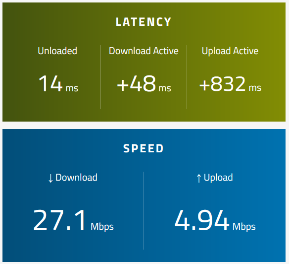

Before queues:

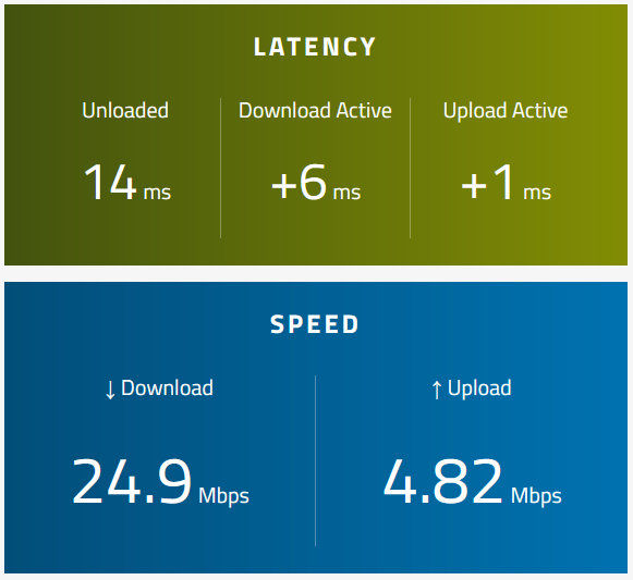

With queues:

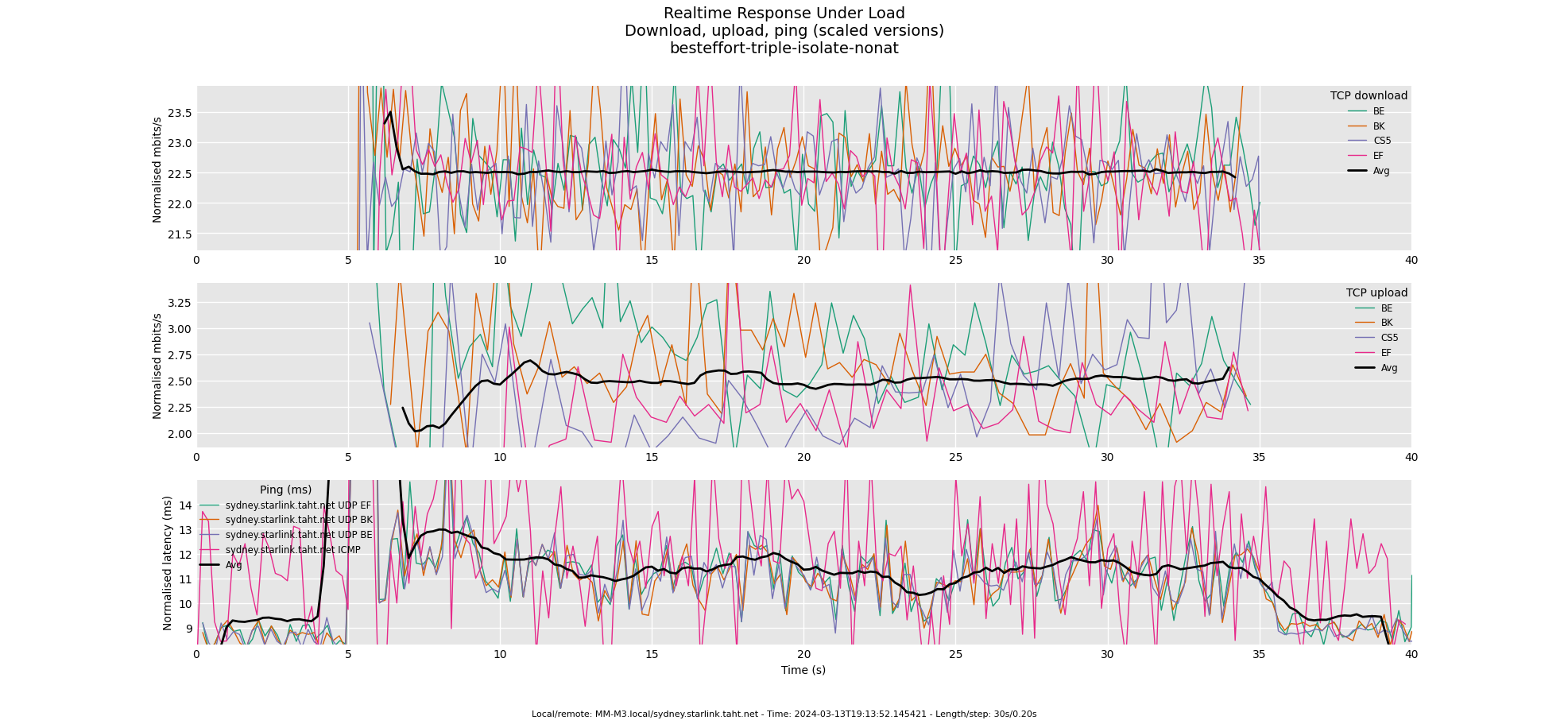

Below are some flent rrul tests.
First image is my standard cake setup using queue types with:
cake-diffserv=diffserv4 cake-flowmode=dual-[src/dst]host  cake-nat=yes
Second image is using queue types with:
cake-diffserv=besteffort cake-flowmode=triple-isolate cake-nat=no
As you can see cake does a great job of queuing and prioritising traffic that has DSCP marks (which flent is adding in these examples).
I fall flat trying to set up mangling properly, but I’d love it if someone could provide some mangle rules to mark DSCP according to cakes diffserv buckets.
