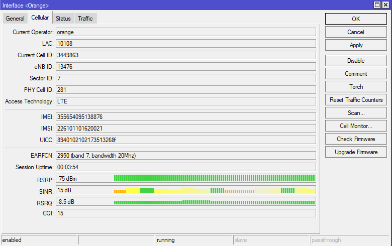

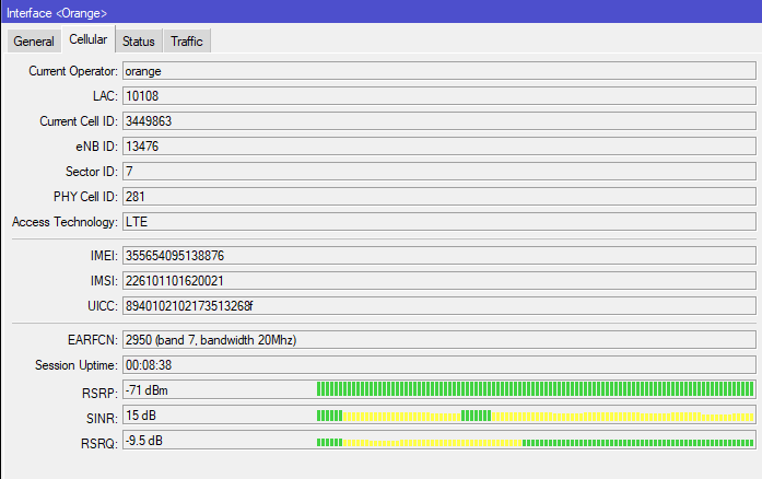

Bought 3 mANT LTE 50 and 3 LTEap mini KITs to be used on the move.
Using 1 m pigtail SMASMA from Mikrotik and 15 cm ACSMAUFL internal one also from Mikrotik.
To my surprise, barebone internal antenna has better signal than the bigger mANT LTE.
Now, when I first tested, with the first LTEap and mANT LTE I thought I messed something while plugging and unplugging the connectors. I even thought that the 1st mANT LTE was faulty.
But, having 3 of each, I can conclude that the mANT LTE 50 is just a marketing gimmick.
That, or I am missing something.
Internal antenna, same location, same SIM, same weather condition.
External antenna, same location, same SIM, same weather condition.
