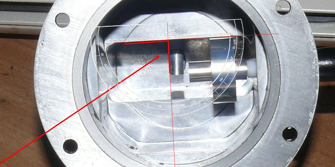

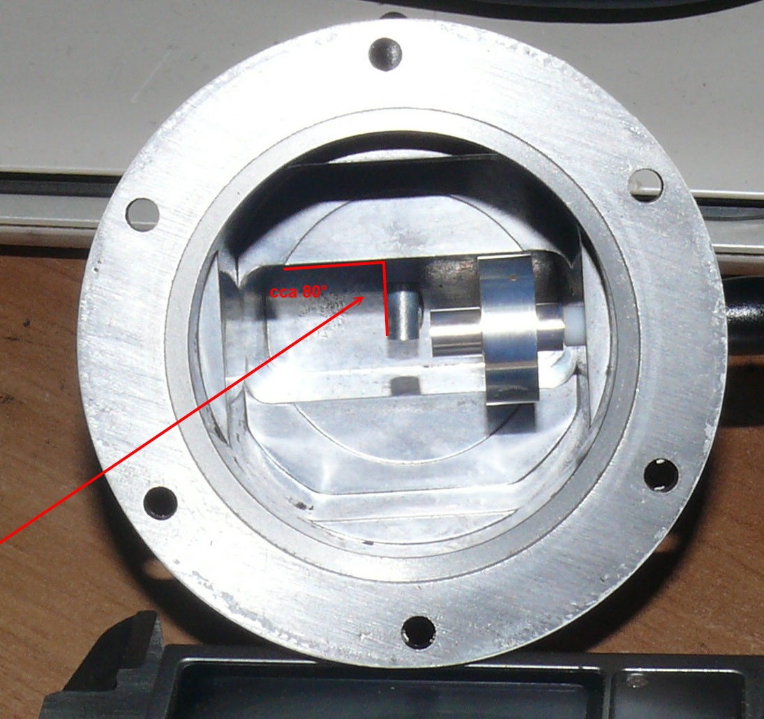

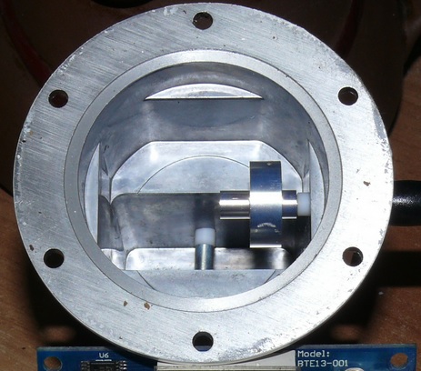

Hello.
If the antenna is disassembled, it is evident that the polarization do not meet at an angle of 90 degrees.
An angle between polarization vertical / horizontal is about 80 degrees.
It is the fault of one piece or?
It is: MTAD-5G-30D3-PA
http://routerboard.com/MTAD-5G-30D3-PA
Have you observed multiple units like this or just this one? Could be a once off coincidental manufacturing fault?
I see maybe 1-2 degree difference, not 10 :slight_smile:
there will be no operational difference
There is better photo. See.
It is really not 90 angles
I agree, that this seems to be a specific case, manufacturing glitch, but still only some 2 degrees. It should not affect the performance.
We’ll see, we test the performance… :slight_smile:
3 degrees cause 1 dB loss … You wont even notice that loss at all :slight_smile:
