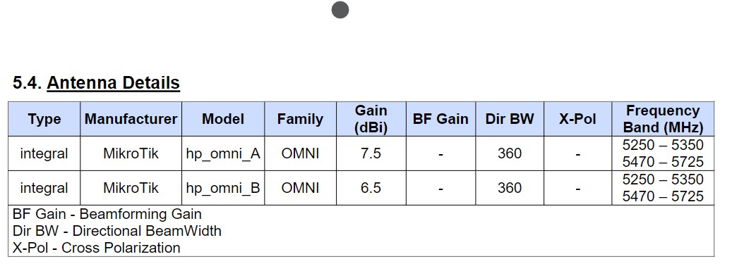

More information on Omnitik 5 ac can be found here: https://fccid.io/TV7OMNITIKPG5HACD/Test-Report/Test-report-5541349
Well, I agree, this is for the US version of the Omnitik 5 ac.
But MT Omnitik documentation gives the same values for the international version.
Device does not allow to set a lower antenna gain than 8 in ETSI/europe, what is in line with the 7.5 of the Omnitik 5 ac tested.

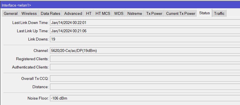

[admin@Omnitik] > interface wireless
[admin@Omnitik] /interface wireless> set antenna-gain=4
numbers: 0
failure: minimal antenna-gain for this country is 8
Also with version ROS 6.49.10, the status info is in line with this (27dBm-8dBi = 19dBm)

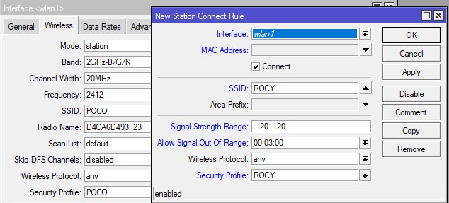

You can try to push stations to the other by using ACLs.
I don’t mean the Access List on the Access Point, I mean the of Connect List on the Station. With the help of Connect List you can set the order of Access Points to which the Station is connected. With the parameter Allow Signal Out Of Range you can make the Station wait 2 or 5 minutes for a signal from the first Access Point and only if it does not appear during this time it will connect to the second one. If the Connect List is not configured, the station will select the AP with the highest signal.
In the screenshot, the station will connect for 3 minutes to the ROCY SSID with the ROCY security settings and only then connect to the POKO SSID with the POKO security settings.
… I mean the of Connect List on the Station.
That’s great if you control stations. But if you don’t (e.g. because stations are customers of a camping place), then this is not an option. It all depends on actual use scenario of @OP (which he didn’t really describe in detail, so we can only guess … and I’m done guessing here
Excellent , learned something new (for me), using the “Signal Out of Range” in the connect list, to delay the decision to try the next one in the list.
