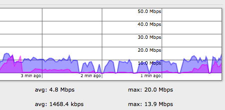

I have an mANTBox 19s, with 19 connected SXT 5s, and I see the following, every so often the total throughput drops to zero. Have tried various combinations of HW retries, protection modes, etc. and see changes in throughput, but the drops are still there:
Any explanation for this?

Have changed to N-only and seeing the same effects. I can improve throughput by adjusting settings, but the complete cut-offs happen no matter what.
What is your Country?
Did you check that the Channel is free?
We have tried all settings, it doesn’t matter if the channel is free or not. We see this on quite clean links. It’d be nice to have a spectrum analysis tool like Ubiquiti has in AirOS 8…
