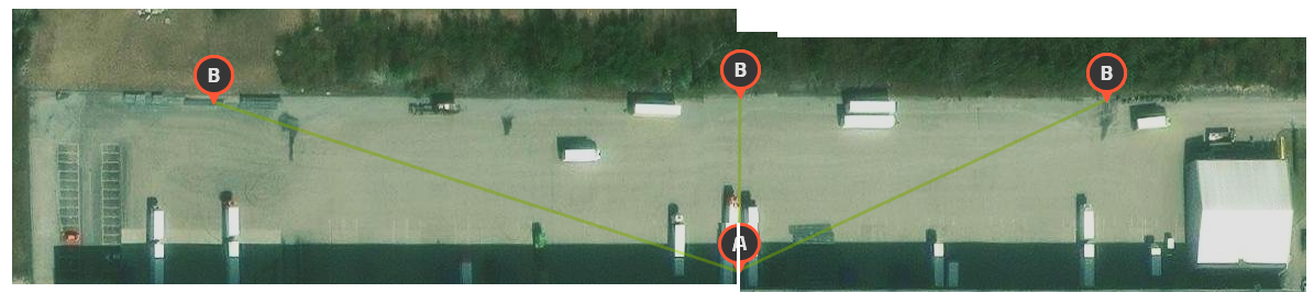

Im currently looking for solution for this setup, would the mantbox ax be able to handle this?
i could do mantbox 12 as well, its for cameras so i have a bandwidth about 30 Mbps but would possible need to mount more cameras later on.
