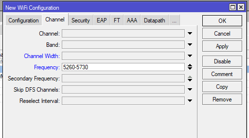

My goal is a fast network, but if I use a 5 GHz network, the network stops for a few seconds. The ping command is also available. When using Teams, it’s more than annoying, it’s useless. If it works, the speed is about 300 MBit. No problem at 2.4 GHz frequency! That’s slow. I tried to set the frequency but I can’t. Only accepts between 5500 and 5720. It cannot be set to the UNII-2 section, due to an Unsupported channels error.
Why can you tear me up? Why can’t I set a frequency?

Based of this you can set your frequency range to either specific frequencies or a frequency range which the device can then auto select the channel.
The help article describes this perfectly:
https://help.mikrotik.com/docs/display/ROS/WiFi#WiFi-Channelproperties

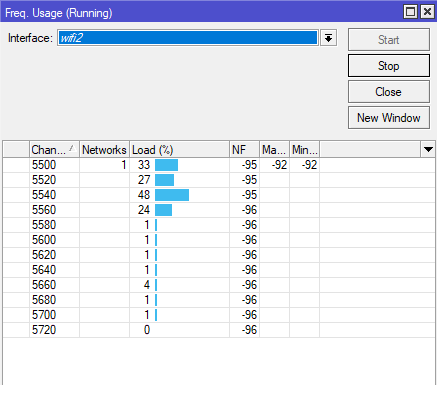

On your screenshot it actually only shows U-NII-2 channels.
But if youd for example only wanted the frequency range that appears to have barely any load on your screenshot you’d set it to something like:
5580-5720
