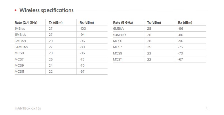

what kind of client cpe can we expect to pair with this? sxt ax, lhg ax?
also, what is the output power and sensitivity , tthere is no mention in the specifications.
You just couldn’t find them, it’s a Mikrotik.
