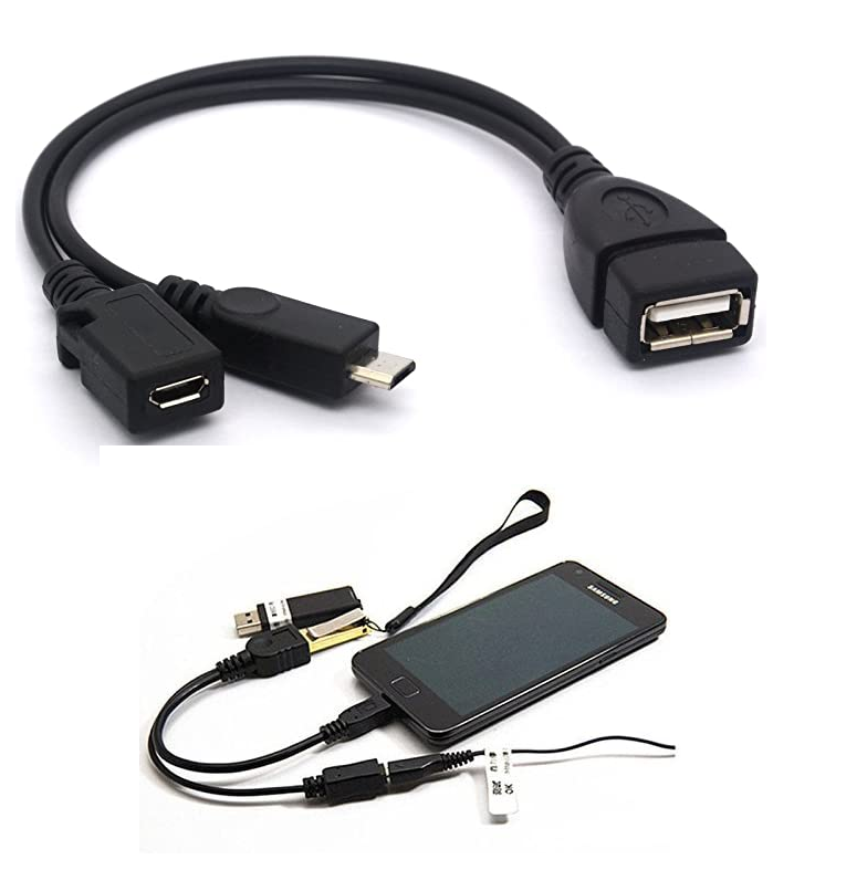

is there some kind of Y-Cable avail to power the mAP via power-bank and use the USB-Host for a serial-USB-adapter at the same time ?

? someone did this before ? … looks viable … but I’m 55-60 bucks away from knowing for shure …
I’ve successfully used mAP 2nD with 3G USB-modem powered by USB OTG Y-cable. The power from male USB-A goes into female USB-A port and OTG-microUSB, and the data pins from last one goes into female USB-A, communicating with modem.
thanks … nice … will see if I can scramble up some money to become a mAP-owner
