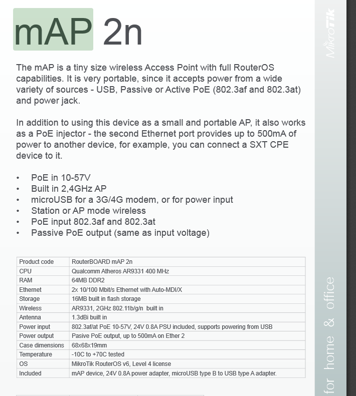

The current product catalog (http://download2.mikrotik.com/2014-Q3Q4.pdf) still claims 802.3 POE compatibility:

mAP doesn’t support 802.3af. This information was incorrectly reported when device was not for sale yet, but we change it in the product page and PDF files. The information could still be incorrect in some other webpages that we don’t control. Printed catalogs can also not be changed, unfortunately.
Who can I speak to regarding RMA authorisation based on missing PoE support? I have 3 x mAP devices to return.
The device was never sold as having 802.3af. The mistake was in earlier brochures, before we started to offer this device. It does have Passive PoE support as it says in the brochure. I’m sorry that you mistook this device for 802.3af compatible. You can talk to the seller about returning them.
