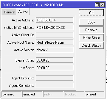

Just tried the config above, clients still can’t receive a IP.
But DHCP server on hEX is trying to assign it, status “offered”:
Thanks community, the problem was in hEX side (incorrect bridge, I guess).
Now everything works fine.
