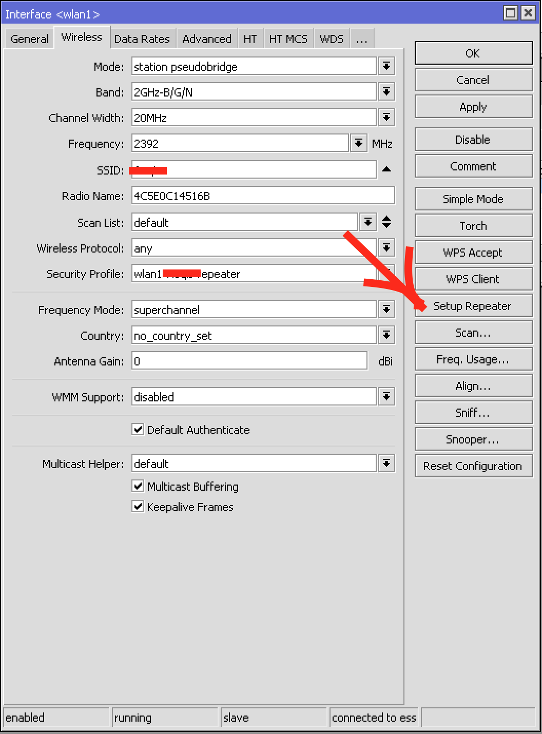

Finally made some progress on this subject. I found the “Setup Repeater” button in the Wireless Interface configuration. With this button I was able to setup a repeater. The mAP Lite is connecting to my WIFI AP, I’m getting an IP address. I can connect with my laptop to the mAP Lite. But I cannot browse the internet, from the mAP LIte I cannot ping my WIFI AP, strange.

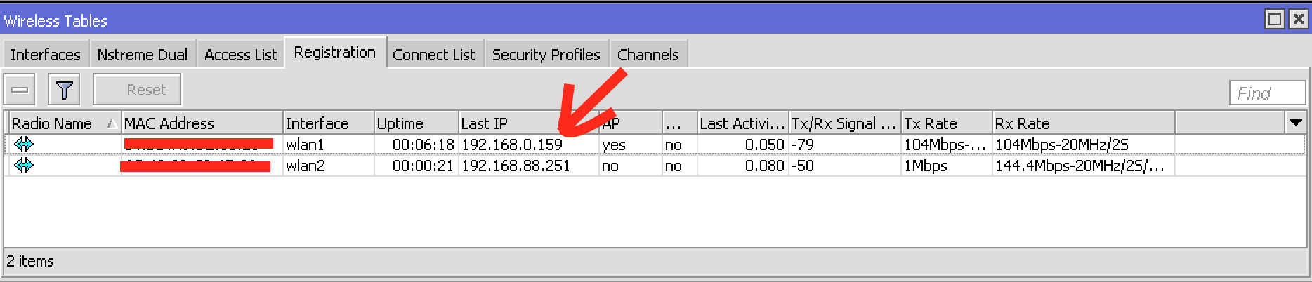

In my debugging process I found out that the wlan1 which is connecting to my WIFI AP (192.168.0.x) is continuously getting a different IP address. Randomly within one minute the wlan1 is getting a new IP address. I don’t understand why this is happening. Any idea how to check this? The logging doesn’t show any error message. This could maybe explain why I cannot ping my WIFI AP or any IP address on the internet.
Above picture shows the connection to my WIFI AP and my laptop connected to the mAP Lite. I noticed that in the AP column there is a Yes (wlan1, WIFI AP) and a No (wlan2, Laptop). And wlan1 is continuously getting a different IP address.

Anybody an idea why my Last IP is flipping all the time? And is this the reason why I cannot ping my main WIFI AP and thus not browse the Internet?
Last ip is not ip of the interface but last seen ip during the communication. Isn’t something like that written in the manual? Have you read it?
It is not the problem and has no influence on the wifi.

  1. Wireless → Interfaces → wan1. Set “station” mode and connect. You will not be connected to the internet. Wireless → wan1 → Setup Repeater. Provide the SSID and “passphrase”. Leave “Address” blank. If you open IP → “DHCP Client” you will see it searching. Wireless → Interfaces will show a bridged interface off wan1

  1. open “Wireless → wlan2” (or whatever your “wlan” is). This is the screen where you “Scan” or “Setup repeater”. You ~may~ see the mode as “station pseudobridge” or “station bridge”. The SSID may be the last Wifi to which you were connected (say, “CoffeeHouseWifi”). The “Security Profile” may be “CoffeeHouseWifi-repeater” if there was a password.
You have to change a few values before you can connect back to “HomeWifi” or any other Wifi.
a. make sure your “mode” is set to “Station” - NOT “station pseudobridge” or “station bridge”.
b. On that same page select the appropriate “Security Profile” from the dropdown or just pick “default”.
c. Hit “Scan” and look for the Wifi you want.
d. Connect as you did above - depending upon if you need a password or not.
