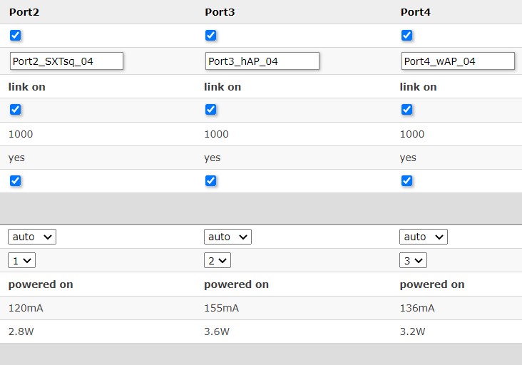

See RB260GSP PoE injection … (no data load) (SXTsq ac 5, hAP ac2, wAP ac)
I actually never checked it myself, but I am surprised re wAP ac reqs. I always counted it as 10-15W AP, but it seems taht realistically it is much lower.
