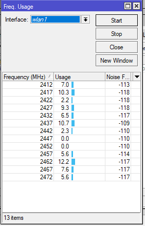

Looking at frequency usage, I don’t see interference as a problem but I did try channels 1, 6 and 11 without much difference. Therefore I wonder: is mAP lite performance really meant just for close range? Even 1 wall can degrade the signal so much?

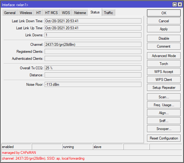

Did you have a look at the CCQ in the registration table? It is a good indication of signal distortion by wall’s or of occurring destructive (adjacent channel) interference.
Co-channel interference cannot be seen on MT while using the channel, AFAIK.
You might be interested in this similar post: http://forum.mikrotik.com/t/inconsistent-speed-hap-ac2-vs-hap-lite/145634/1
I don’t see CCQ in the registration table. Just on the AP in the wireless interface status. And it’s between 20-30% (with client on the same floor, distance from AP = 7 meters, room across the hall, door open).
Overall CCQ is not specific enough. The per connection CCQ is in the registration table (select the CCQ column to be displayed). With CAPsMAN it could be in that registration table, not local.
20-30% is rather poor. Every packet has to be sent 5 times on average. Consumes a lot of airtime, and I assume with this CCQ level the interface rate is very low (expecting close to 6Mbps, with 5 repeats, and 50% overhead … this will get very slow) and that again takes more airtime. ALL on channel 6 (2437) will be slow if you start data-transfers because of all the airtime consumed.
Surprised to see 28dBm as transmission power. This is way stronger than the client device. Can be done indeed in the United States, but this AP is not strong enough to deliver that. Previous TX power was 20dBm, there was also “b” speed enabled, down to 1Mbps. Well actually I don’t understand “mode 20gn” with “basic rate CCK 1-11”, but OK the config says b/g/n what explains the “b” rates. But why has it a status of single stream (1x HT:0-7) ? The mAP Lite is a “nD” device, 801.11n dual stream. Well, I’m not using CAPsMAN so just odd to me to see those numbers.
On your power drops … RF power drops 6dB for every time you double the distance. 6 dB drop is 1/4 of the power as the surface of the globe around the AP is 4 times bigger.
If you have -65dBm at 150cm distance , then 6 times halving that distance gives an increase of 36dB in free field, or -30dBm at 2.3 cm. Given the fact that the RF signal around the AP within 30 cm is far from constant, and the fact that -30dBm probably saturates your receiver, and as you have indoor reflections, the number you see are far from special.
5 cm is not a safe distance to stay near the AP.
What happens through the wall is another story. We see RF signal as light, but actually the transmission is quite different. Losing 20 dB is normal, a drop of 20% in the CCQ is the painfull part for the wall passing.

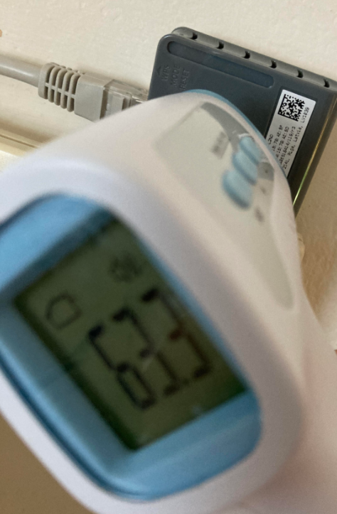

I’d just like to post an update. I still have issues with mAP performance but I think it might be a temperature problem. The surface is qiute hot. I didn’t pay attention to this at first but recently I mounted the unit using the supplied metal plate but after about a day, the adhesive tape started to melt and the metal plate shifted on the surface. It’s holding pretty firmly when I remove the mAP so the glue is fine, it’s just the mAP is so hot, it melts it. So even Mikrotik didn’t expect it to be so hot.

30 minutes after powering up, the back side of the mAP surface temperature reaches 57°C. That’s with one client connected and Tx power down to 12dBm.
after snapping the mAP to the supplied metal plate and checking again in couple of minutes, the temperature is even higher. Seems enough to start melting the glue. Is this really OK and expected?
Measured temperature in Celsius!
Reading of temperature is not visible ?
But >57C is not normal, no.
After another test, only 40C when powered from USB, compared to 63C with active PoE.
