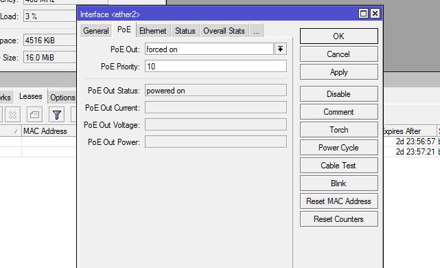

also should i be seeing values in the below picture or just powered on?

how about the missing POE values in the screen shot?
it is not capable of showing power consumption.
only option is status, where you can see if connected device is powered on, or other internal statuses of PoE-Out
