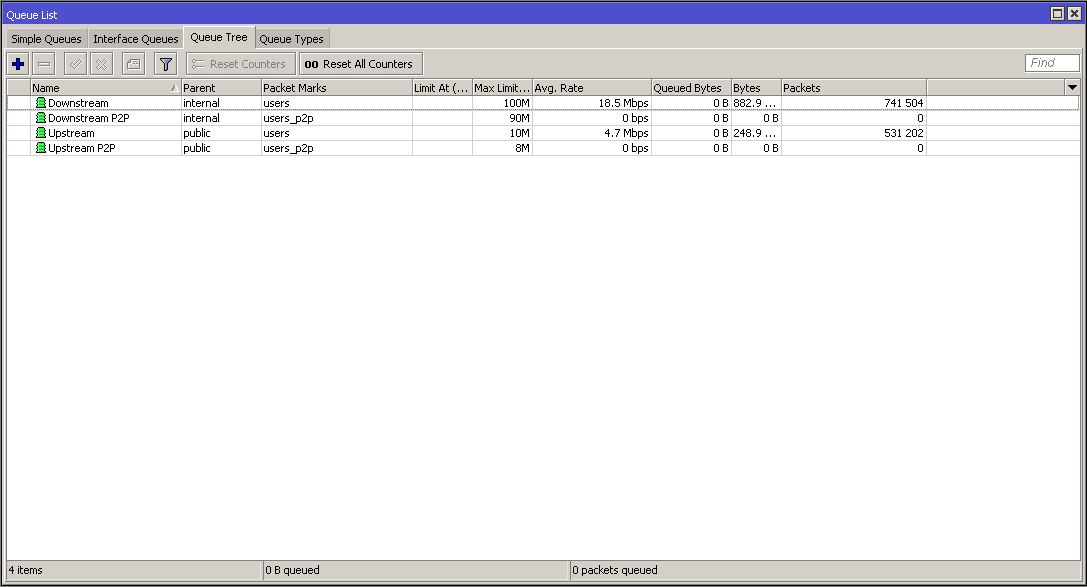

I am watching the queues in winbox, see screen shot attached. As you can see, only my normal traffic queues are filled at the moment,

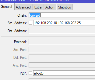

using the IP->Firewall with “Mark Connection” and “Mark Packet” to put the packets in the according queue (2nd screenshot)

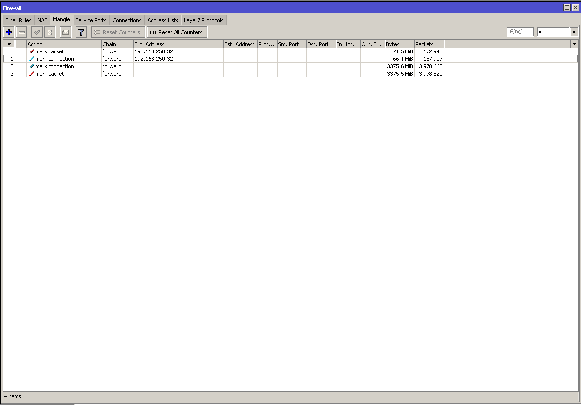

If I change the IP->Firewall rule to mark not by traffic type, but IP address it works again. So generally the marking seems okay, just the P2P filter is obviously broken at least for bitorrent.

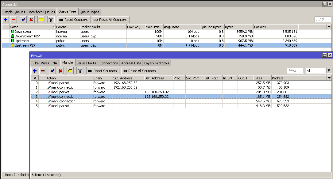

So actually I have made a work around now, by just marking all the packets from the server and putting them into the users_p2p queue,
that still works, as the screenshot shows.

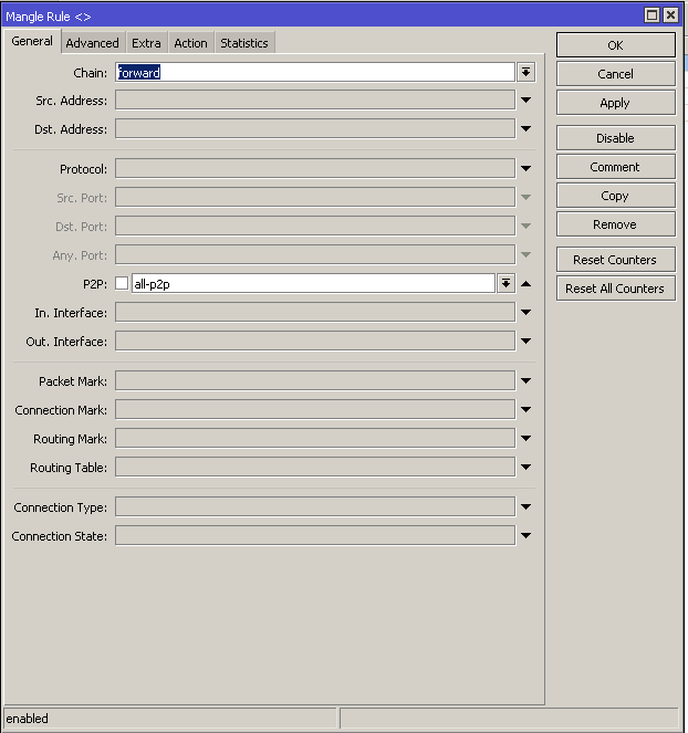

Thanks for confirming this @Masyanich!
We have confirmed it as a bug, thanks for letting us know. We will fix it.
