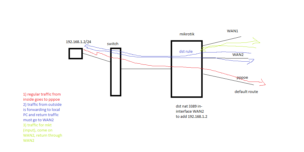

i have wan links on mirkotik, two links with static ip, and the third is pppoe (dynamic ip), default route is over pppoe. what i want is when something came to mirkotik on WAN1 or WAN2 i want that that traffic is going back the same side its came. i did some mangle and routing mark, nad when i connect to mirkotik on WAN2 it returns traffic on WAN2 (thats good), when i trying to connect to some device behind the nat doesnt work, connection failed.
Some example how to setup marking on WAN interface so that all traffic is going the same way back?

These are marked in the input chain which is traffic to only the router. You need to mark things in prerouting for traffic through the router.

in my situation i need that all local traffic is go outisde through WAN3 (pppoe), no need for PCC (i think), only trafffic which is coming on WAN1/WAN2 is going back through that interfaces (for both kind od the traffic, which is coming to mkt (input) and for traffic which is coming through WAN1/WAN2 and is forward to local ip->and go back through the same interface WAN1/WAN2)
any example for that scenario?
picture in the attach
Your right you don’t want to use PCC. But you do the same thing minus the rules which use the pcc classifier for policy routing.
i follow the example and it seems that everything is working fine now, thanks :slight_smile:
