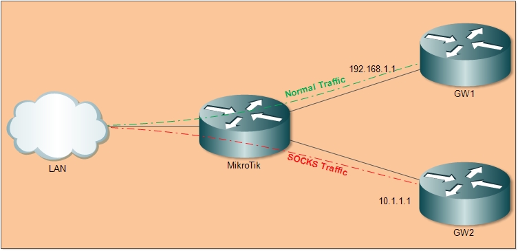

assume that mikrotik has 192.168.1.1 as default gateway, but for socks traffic i want to route the traffic through 10.1.1.1 instead of 192.168.1.1.
i mean on a single LAN, users not using SOCKS should route to 192.168.1.1, and users that are using SOCKS need to be routed to 10.1.1.1
i’ve also attached a diagram.
I understand what you want, but I don’t think it’s possible (in a clean no-sideeffects way). Unless there’s a feature that I don’t know about, that would mark connections made by proxy (I’m pretty sure there isn’t, but it could be interesting if it was), you can’t tell proxy traffic from other traffic originating from router. What you could do, would be sending forwarded traffic to GW1 and all traffic from router (which would also cover proxied traffic) to GW2. You could set some exceptions, e.g. DNS queries going to GW1, atd.. So it might be usable.

Proxy client is located on LAN, and the server is mikrotik. Do you have a solution for this case?
Sent from my iPhone using Tapatalk
No, there is no solution for that case, when you don’t want to change anything to the proxy.
When you move the proxy into the MikroTik shown on the picture, perhaps something could be done.
(although I do not have a ready solution for that, either)
