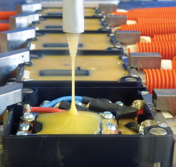

Solder all the cables, or drown all the stuff in epoxy :slight_smile:
There is no limit to creativity.
That’s a good one! There was a business which hotglued the USB ports of its desktops.
But I imagine he doesn’t want to “destroy” the hardware. If this is acceptable, then yes. Glue the cables, weld the wires… why not? :smiley:
