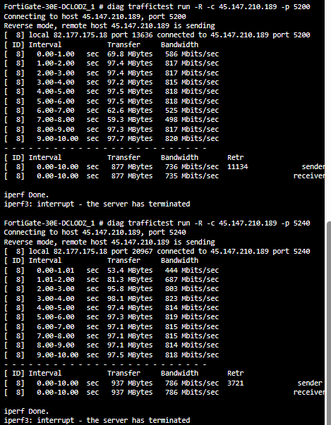

The speed between the switches is as follows
And this is what the speed looked like before I tried to fix the problem… As you can see I messed something up but it doesn’t change the fact that the speed is there

Your screenshots show that you’re using built-in bandwidth test. It is a well known fact (you’re excused since you’re new to ROS) that bandwidth test is heavy on CPU and on many device models it itself is a bottleneck.
It is recommended to run tests using two external devices, known to be able to create and absorb lots of traffic. Many if us use a couple of PCs running iperf3.
So please explain your actual problem and don’t try to illustrate it by showing some results of artificial load. This may then allow us to help you solve the actual problem.
