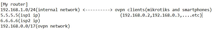

Hi! I’m using mikrotik router with 2 different isp(autoswitching beetwen them using distance of default route). Also it is used as ovpn server. You can see simplified network schematics in the attachment. To give my internal network(192.168.1.0/24) access to the internet, i’m using this rule for masquarading
chain=srcnat action=masquerade src-address=192.168.1.0/24 log=no log-prefix=“”
ipsec-policy=out,none
, as seen, it hasn’t nor out interface nor dst-address set up. Everything is working fine, but i want to know could something be wrong because of that? And if it could be what exactly? Thanks :slight_smile:

Overlap is needed because some clients are android and apple devices, they should get access to other clients(another mikrotik routers) networks, but mikrotik’s ovpn implementation doesn’t include pushing routes to clients. Settings routes manually on mobile devices is also problematic, you need root access or jailbreak.
but it is also NATs traffic from LAN towards VPN network :slight_smile: i checked that, trying to get access to network BEFORE one of the clients(it is mikrotik router behind huawei gpon modem, needed access to that modem). I succeeded but yes, lan to vpn is also NATed with this setup. But i don’t think this is a problem
