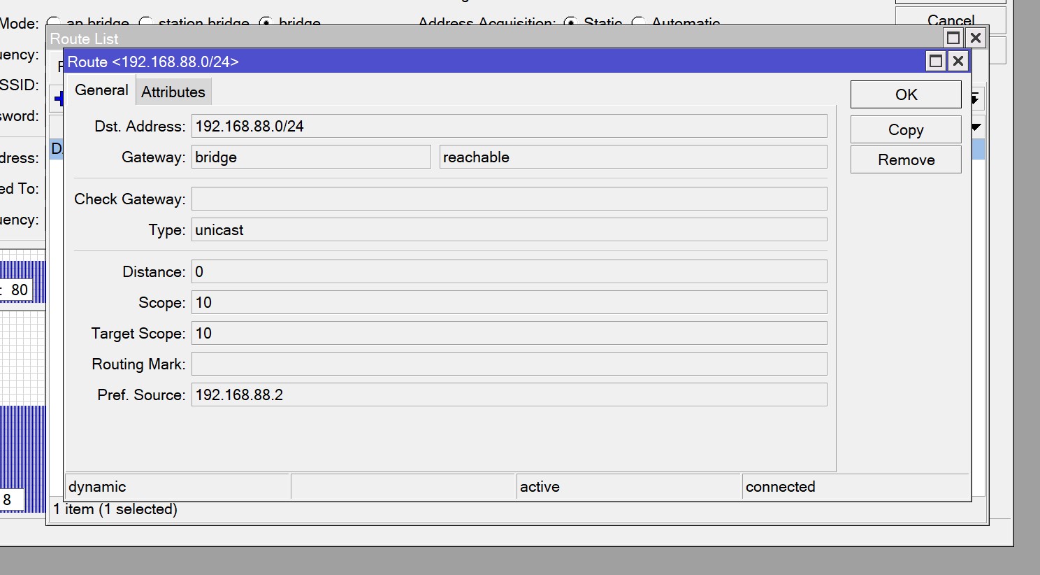

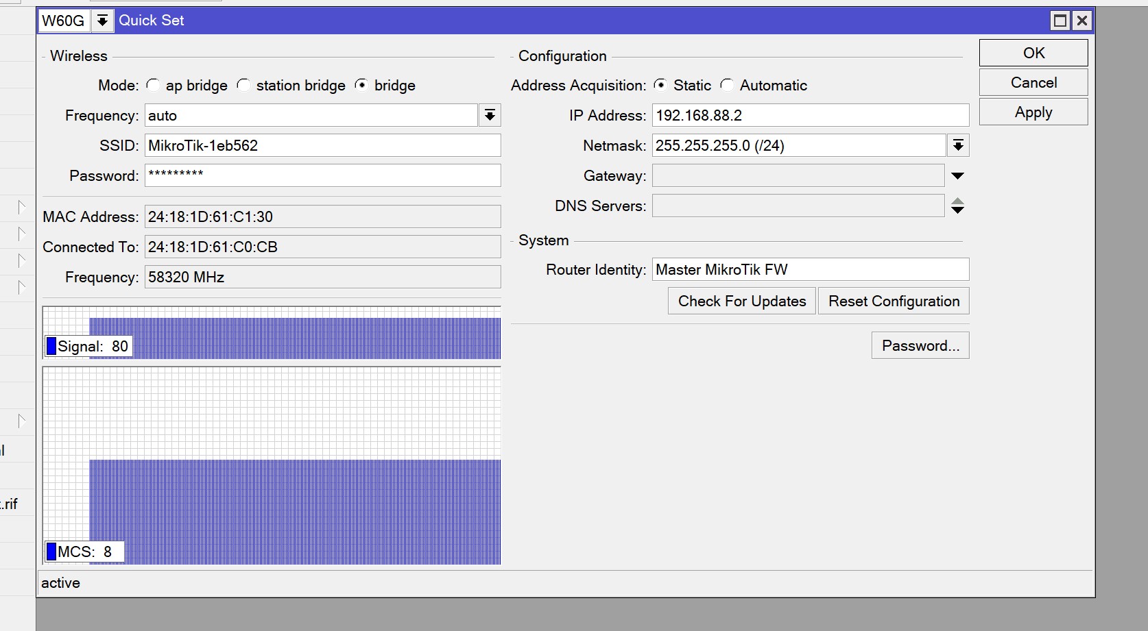

Can you export the IP address and Routes config so i can see it ?
These are screen shots, not sure how I export them?
Thanks.
How can you possibly ping 192.168.160.100 when your Antenna has the 192.168.88.2 address ?
Change it to 192.168.160.X , where X must not be used from another device in your network and add your Gateway/DNS 192.168.160.100…

It won’t let me change the IP. I am choosing auto and nothing and then I’m typing in myself and it changes back.

I read your first post again, you never say it changes back to 192.168.88.2… you dont use safe mode right ?
If you are familiar with winbox try to change the IP from there…
Im not in safe mode and I am trying to change in Winbox.
Just to mention, it is not a good idea to use Quickset for an already configured Device…
