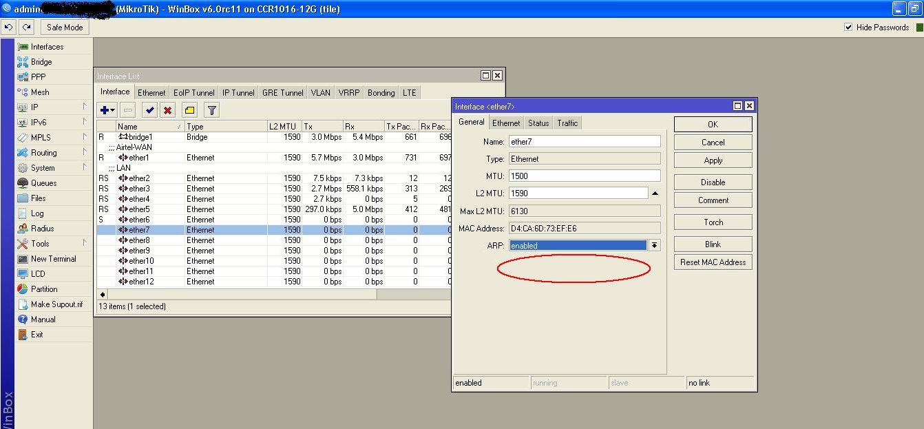

Hi anyone..
Master Port Option not available in My CCR1016-12G plz advice what to do…
Hi anyone..
This is because CCR doesn’t have a switch chip. You can bridge ports if you want to.
is so bad, switch chip is a great tool for traffic performance
The idea is: CCR is fast enough to do full speed bridge in Software.
Then you have more control on traffic with filtering.
is so bad, switch chip is a great tool for traffic performanceThe idea is: CCR is fast enough to do full speed bridge in Software.
Yes, I know, but switch software (bridge) is more slow if I do not have control.
how much more? =)
