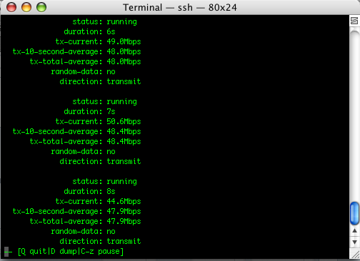

side1 to side2 → 12km
link level: -65/-60
link speed tcp: 60/62Mbps single direction.
link speed udp: 70+ Mbps single direction.

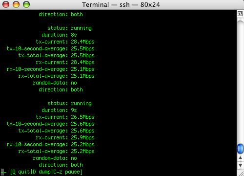

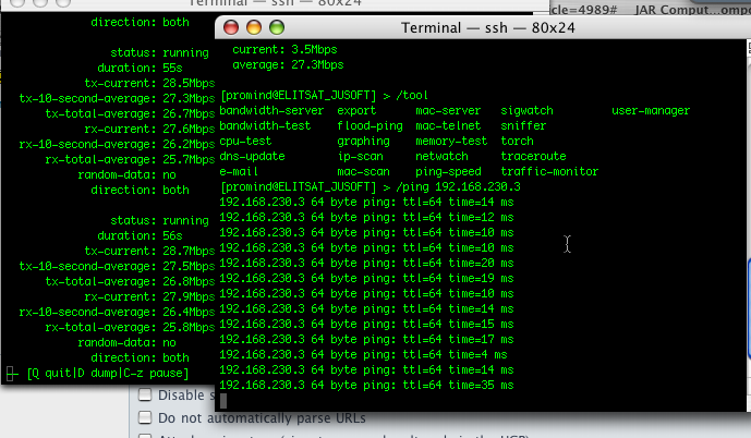

have you never try in both direction contemporarly? what is your ping while have that performance?
Transmit: ~60M.
Both: ~40M/~25M.
ping: ~10ms.
*Note that there are ~15Mbps active at that moment so they cannot be seen.
