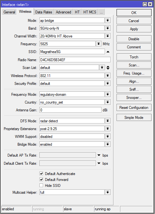

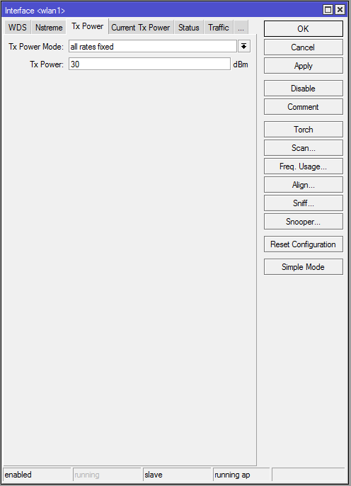

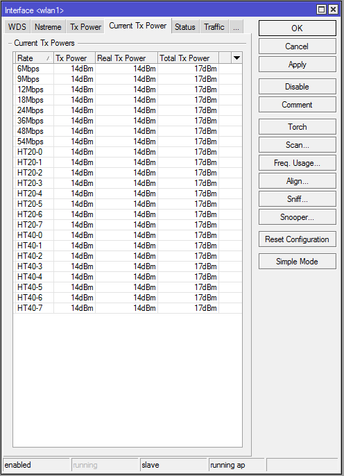

  • Even specifying a higher Tx power level manually has no effect, even with regulatory domain unset (all rates still show +14 dBm in Current Tx Power, with +17 dBm Total including the +3 dBi antenna gain that also cannot seem to be adjusted properly) (see attachments)

most likely your radar-detect found the lower channel frequency as suitable and there output power is lower. Check the Status page to see what frequency the wireless interface uses.
If you use frequency-mode=regulatory-domain you can’t override the tx-power above the regulatory-limit.

After running a sweeper I noticed my frequency selection never took effect. The lowest channel (#36, 5180 MHz) was always being used, regardless what the RB was configured to use.
Turns out, when DFS Mode is set to anything except “none” the RB will only use #36, 5180 MHz. I believe this is a bug? Because DFS is specifically meant to help with radar interference in the middle and upper part of the band, not the lower part. The Unites States regulatory domain even requires the use of DFS in the middle and upper band, but not the lower band.
However, when I set DFW Mode = none, and then select a high channel (#161, 5805 MHz), I see the Tx power levels increase to +27 dBm (with +30 dBm including the +3 dBi antenna gain, which btw is still not working correctly because I have the gain set to 0 dBi).
So it seems to me there is a bug where DFS isn’t working properly when selecting any but the lower channel. And in the United States regulatory domain this should be required.

Antenna gain works in regulatory-domain setting, since regulatory requirements refer to EIRP, which includes antenna gain in calculation.
