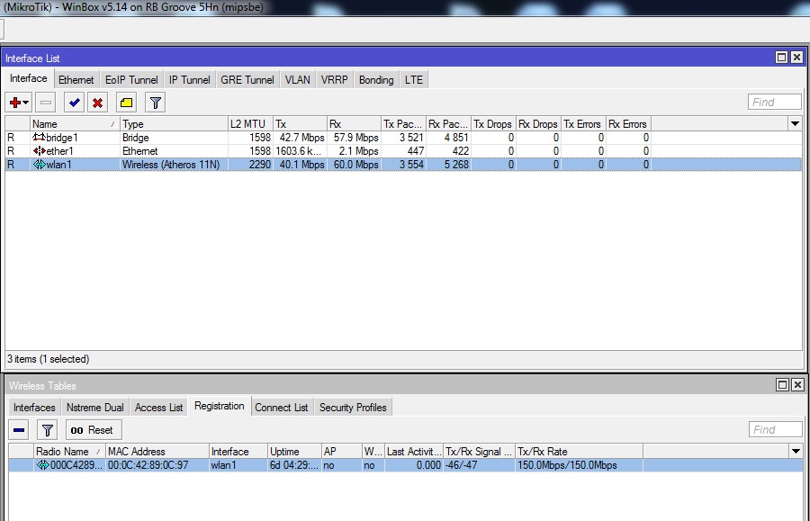

not always configuration is the problem. describe your antennas, the distance, the visibility, height of antennas etc. did you scan the spectrum and see if there is interference on your channel?
No. This is a back-to-back testing using 29dbi antenna,radio signal level of -41dbm, 1 kilometer distance. We get a maximum throughput of 20Mbps full duplex. Any suggestion to increase the throughput?
signal is much too strong. reduce output power to keep the signal at -55 or -60.
10km with -46
wonderfull, tell me your configuration.
