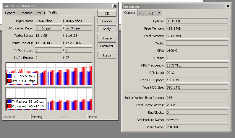

We got RB1000 for a test today. Put it in place of one of the border routers, disabled conntrack, empty firewall, queues, etc. The device was only able to pull around 55000 pps or 350 mbps, less than our Quad-Core machines and far less than the specified 400000 pps. Screenshot is attached. I am not sure what we can do now - there some 3.6 ghz CPUs out there, maybe we should try one of them.
Can somebody confirm or deny my findings?
