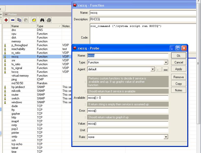

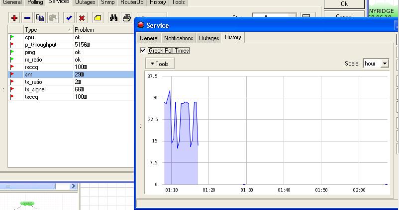

Have a look at my attachments…The probe-function.jpg shows my configurations to pull the stats from the Mikrotik…and the service graphs shows that the dude gets the values from the mikrotik when I add the custom probe to the device, but for some reason the graphs do not show…
Any ideas?
Fixed it :slight_smile: !!!
I changed my error condition to “” and the graphs magically started working :smiley:
