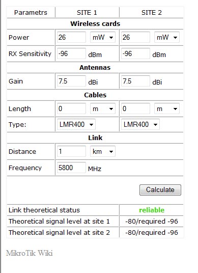

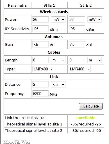

The max reliable distance between two Omnitiks is 1 km.
According to Mikrotik Link Calculator.
Look at the power field, you have set 26 mw, but omnitik gives you 26 dBm that is 398mw.
Dang! You are right, I didn’t change the dropdown to dbm!
Ok, so the actual answer with that calculator is 6km. Although, i think that would be pushing it, especially since both ends are omni. The actual practical limit is probably around 4km or less, depending on surrounding noise.
