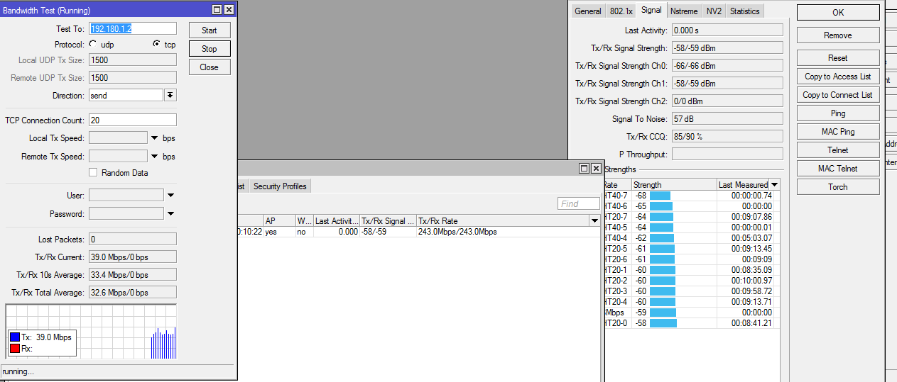

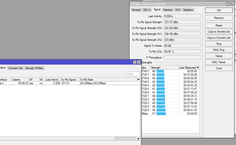

i did a real test with 1.2Km distance with SXT 5Hnd and we was able to get 42Mbps/38Mbps with a clear LOS.
also in a link with a 3.8Km
