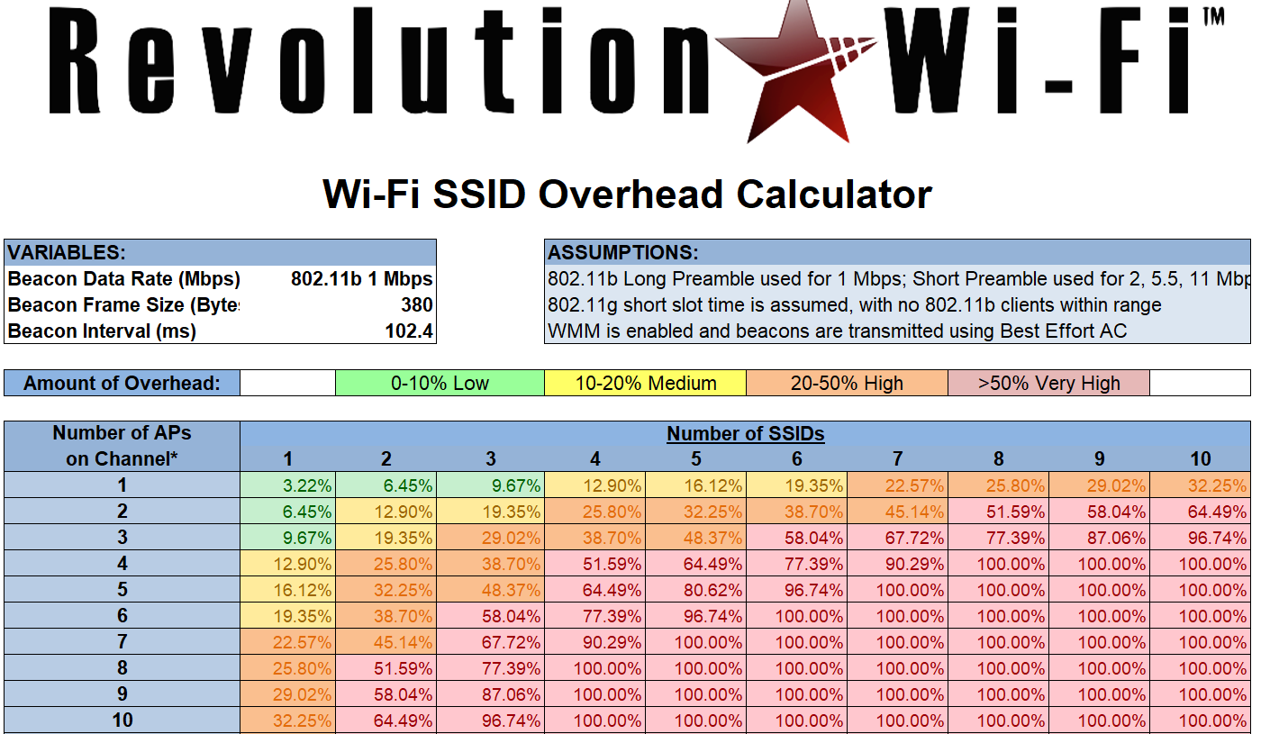

Every SSID you add results in a loss of bandwidth for every beacon and other frills that need to be created,
because beacons are transmitted at the lowest supported data rate.
For example with 10 SSIDs you lost on 2.4GHz as 10% of the bandwidth (not counting the interference).
I don’t know the suggested value, but the value you can accept is important.
worst case scenario 1mbps beacon

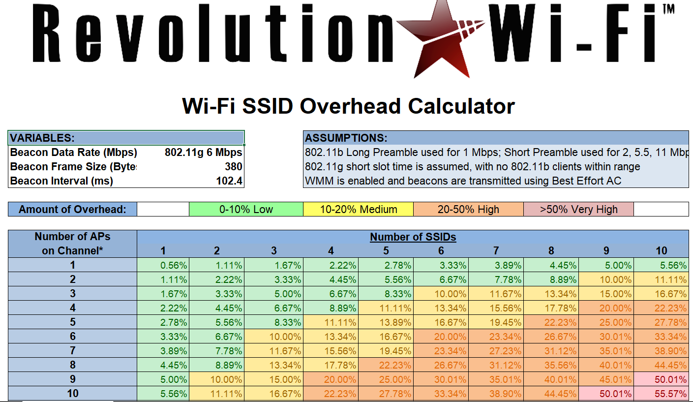

for 2.4ghz is a little fix but a big improvement, 6mbps beacon, this is the worst case scenario in 5ghz
