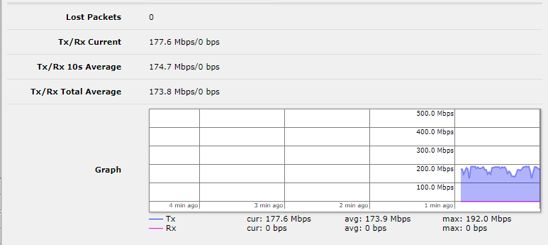

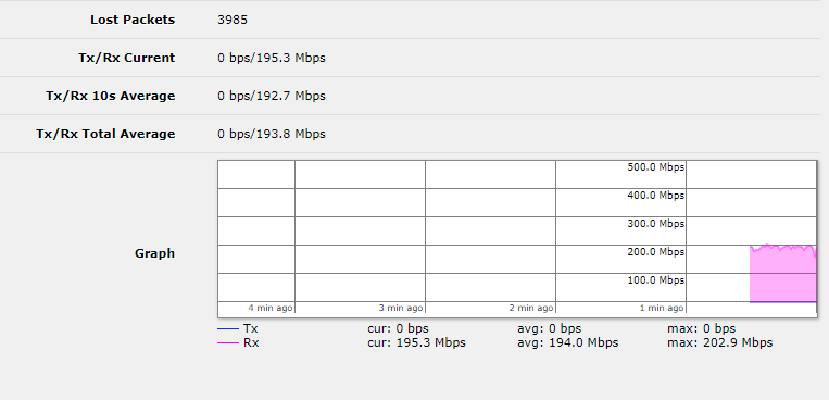

I recently bought and connected a connection between 2x sxtsq 5 ac. The distance between them is 1.3km. The current maximum speeds on the client are: RX - 200mbps, TX - 180mbps. (tested with Btest, UDP).
Here is screen from client:
Here on client RX rate is jumping a lot from 6mbps to 390mbps

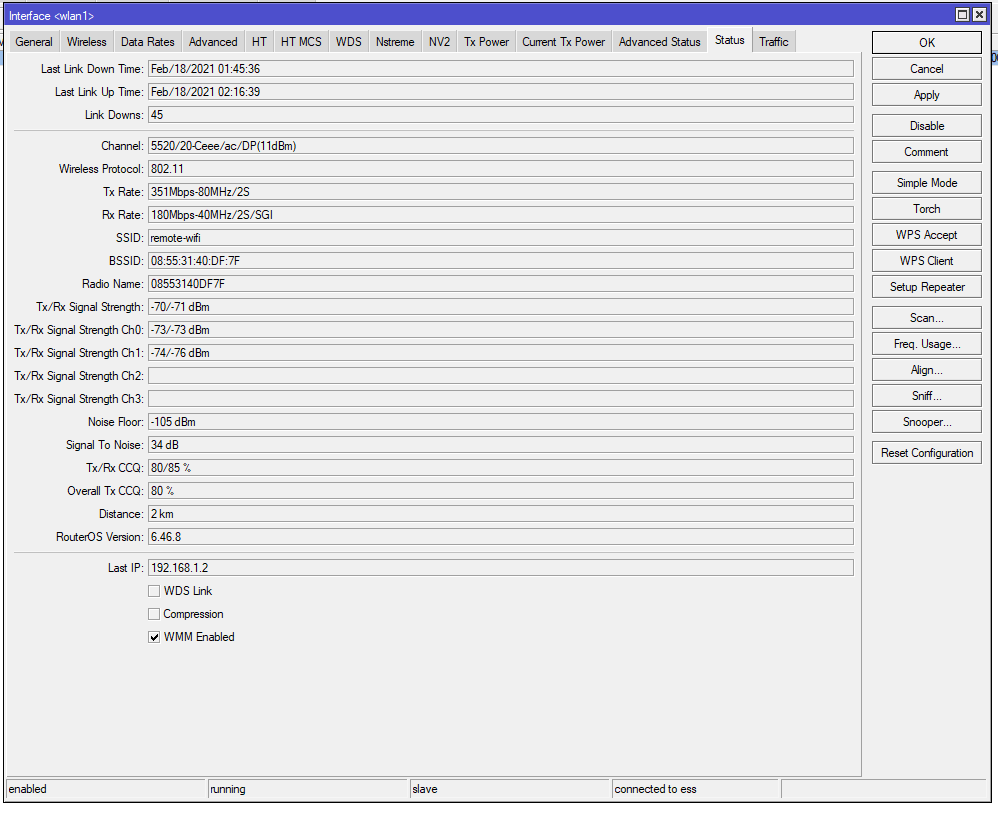

Well … using “auto” frequency means not going for a tuned environment.
The AP picked 5520/Ceee (it could have been even worse) , but still it’s setting the 80MHz channel somewhere in the middle of that band with only 2 (sometimes up to 3) 80 MHz wide channels.
Better use of that band without overlap is 5500/Ceee , 5580/Ceee (10 minutes startup delay!), and 5640/Ceee (only available if 5720 is allowed in your region)
There is interference in the signal reception (interference it is always at the receiver side only, but it is at THIS receiver).
This makes the ac VHT MCS encoding drop from 866Mbps/80MHz/2S/SGI to 180Mbps/40MHz/2S/SGI , or only the very reduced MCS04 encoding (16-QAM) on the lower freq part of the channel.
This points in the direction of interference on that side. The signal is strong enough, but co-channel interference is not about signal strength.
Interference may come from the original signal by reflection and diffraction, or from any other source transmitting on one of the two 80 MHz wide channels.
My recommendation: check for free airtime with “Freq Usage” and “Snooper” and handpick the channel. Also check the placement of this SXTsq 5 ac. (e.g. it is very sensitive for any other AP nearby, especially in the front direction over a wide angle.)
Seeing 6 Mbps rate with low traffic is normal. This is the basic-rate you use by default for beacons, probes and broadcasts. Changing the basic rate to 12,18 even 24Mbps is one of the known tuning acts. But first get the normal payload datarate up to decent numbers.

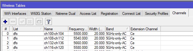

To avoid the 10 minute wait channels, you could set Skip DFS on “10 min CAC”.
As DFS could change the frequency when there is a radar detect, I personally work with the Channel list, to set my ordered preferred list.

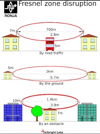

Also check the “fresnel zone” , on a large distance link, the diameter of the fresnel zone can be quite big.
