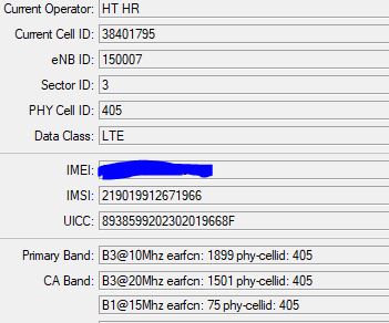

That modem supports only 2CA, mobile phone supports more thats why you get better speeds on phone.
I recently installed also here in Croatia HT link but with
https://mikrotik.com/product/lhg_lte18#fndtn-specifications
It connects to 3 freqs same time and i was getting over 300mbit with not even full signal.
That’s the difference between LTE18 and LTE6, yes …
