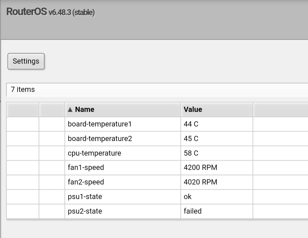

my cpu tempreture always between 55 to 60c
is it normal temperature
If not then what is the normal temperature for ccr 2004
